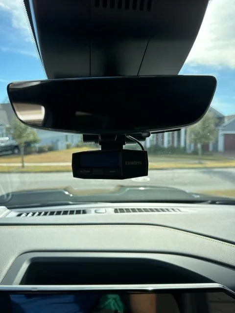

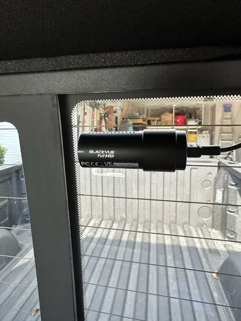

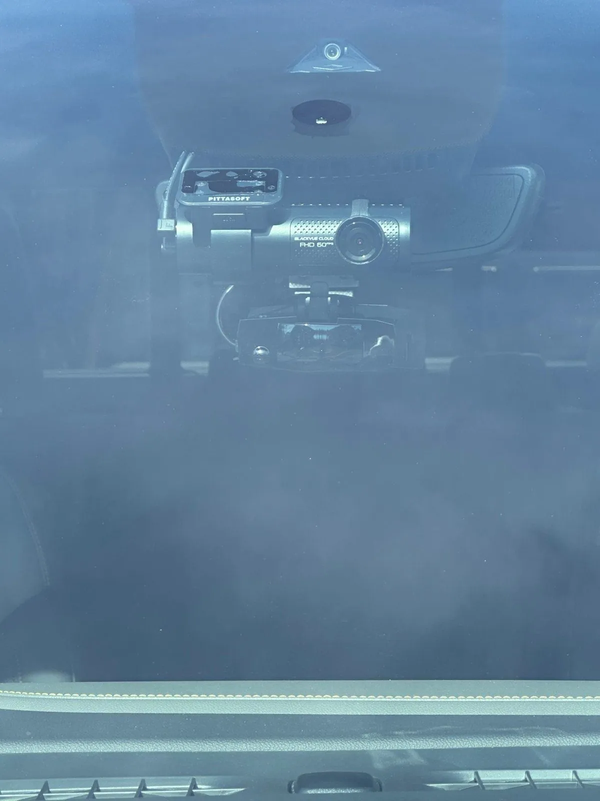

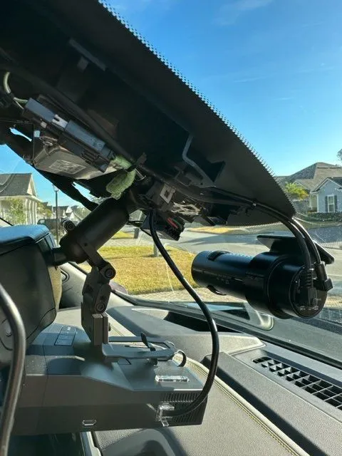

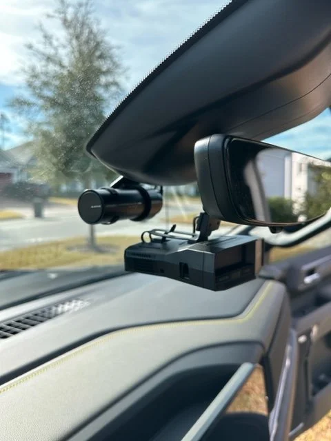

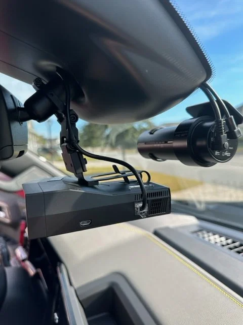

I reached out to them today about trying a dual unit mount...Just completed the installation of my Blackvue DR750X Plus 2CH dash camera and my Uniden R8 radar detector on a Blendmount. As OEM as I can get it. Cut a notch in the bottom left of the mirror shroud and routed all wiring through the shroud and into the headliner. Came down the passenger A-pillar to the fuse panel. Rear camera was routed across the headliner with the cable secured BEHIND all airbags. All I am waiting on now are my fuse taps to tie them in for power. Very happy with how it turned out. Happy to help anyone that has interest in doing this as well. I have been installing electronics into vehicles since I was 14 years old. Happy New Year everyone!
Very nice, i am doing the same on my 26 3500 gasser, i ordered a harness for my uniden r8, but where did you pull for the cameras, i have a dual camera set up as well, and wondering how to hide those wires.Just completed the installation of my Blackvue DR750X Plus 2CH dash camera and my Uniden R8 radar detector on a Blendmount. As OEM as I can get it. Cut a notch in the bottom left of the mirror shroud and routed all wiring through the shroud and into the headliner. Came down the passenger A-pillar to the fuse panel. Rear camera was routed across the headliner with the cable secured BEHIND all airbags. All I am waiting on now are my fuse taps to tie them in for power. Very happy with how it turned out. Happy to help anyone that has interest in doing this as well. I have been installing electronics into vehicles since I was 14 years old. Happy New Year everyone!
I'll send you a PM and include my cell phone so we can chat on the phone. Easier than typing a ton.Very nice, i am doing the same on my 26 3500 gasser, i ordered a harness for my uniden r8, but where did you pull for the cameras, i have a dual camera set up as well, and wondering how to hide those wires.
