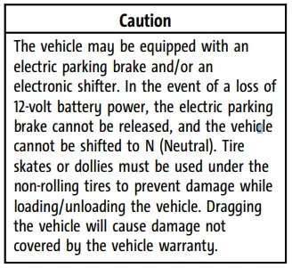

Appears you cannot release the parking brake or shift into neutral with a dead battery. Page 411 (Link to Manual)

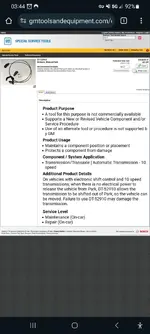

Leave it to GM to not only require a special tool, but one that needs to be installed while the truck is on a lift or jack.
Super convenient if you break down.
