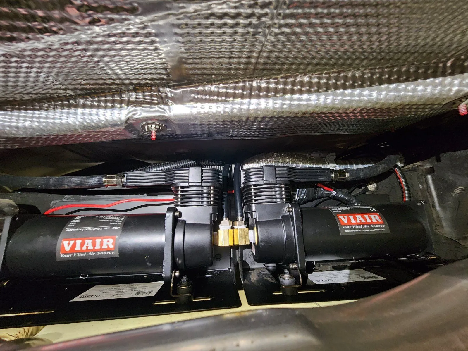

Nice info. I saw Viair but thought they might be additional tanks.
Looks like links are not working.
Oops, They should be fixed now. Always have trouble imbedding links off my phone.
Yeah, Pics aren't great. I just took a few in a hurry. It was late and I was tired haha. Here is the same compressors in my other truck. Little better picture of them on the mounts.

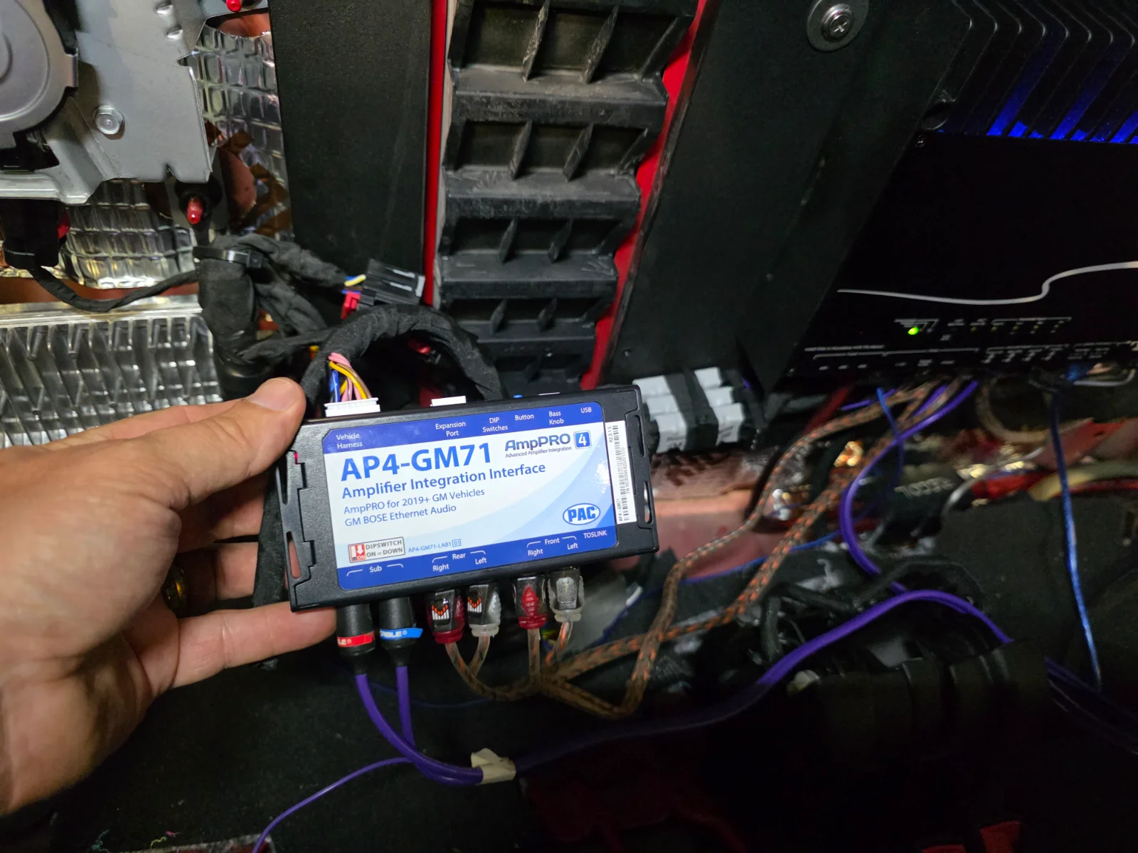

Guess I could update this post. I ended up deleting my Bose amp with a PAC AP4-GM71. Stereo sounds great and this is a much better option then trying to tune around the factory amp. The PAC also allows you to adjust the Chime volume or mute them all together. If you turn the chime volume down all the way it also effects the blinker sound. But if you mute the chimes and leave the chime volume up the blinker sounds stay and just the chimes go away.

Guess I could update this post. I ended up deleting my Bose amp with a PAC AP4-GM71. Stereo sounds great and this is a much better option then trying to tune around the factory amp. The PAC also allows you to adjust the Chime volume or mute them all together. If you turn the chime volume down all the way it also effects the blinker sound. But if you mute the chimes and leave the chime volume up the blinker sounds stay and just the chimes go away. View attachment 22980View attachment 22981

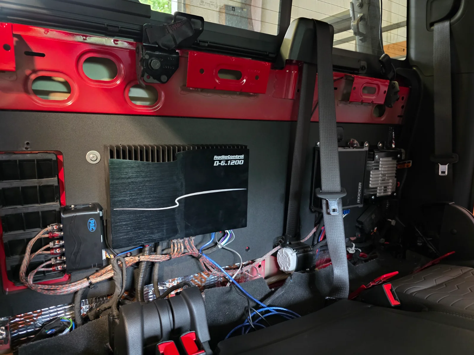

Hey 8ball- I have question about your PAC AP4-GM71 install, I was hoping you could tell me which PAC AP4-GM71 data harness you used? I'm in the process of installing one too. The closest I found was the (E) harness. All its pins hit wires in the factory plug but not all the wires. I'm guessing not all are needed. I had a BOSE harness by A.I.S. (Audio Integration Solutions) for my AC D-6.1200, I tried to tune it to get it to sound good to my ear and was never successful. So I'm going to give the PAC a try. I also replaced all the speakers with Infinity's. Thanks for your great posts and any insight/help on my current issue

I replied to your DM, but ill post it here too. I should have mentioned it in my post.
ZR2 uses harnesses A and E. You also want to download the V24 utility from PACs website to be able to adjust the settings for it. Chimes, hands free, ect

BTW your install looks great! Very clean. I know how tidies that can be. I got a little lazy on mine thinking it was behind the seat and no one would ever see it but me. I mean I then turned around and posted a picture of it on the internet 😅

Thanks 8ball. The usb cable is a great idea. I'm going to get 2 and have one for the DSP amp as well. Hopefully can get to it next weekend to finish.

Np, that's exactly what I did. Both cables are rolled up tucked away under the seat. Makes it way easier if you need to change any settings. I used this one for the PAC it has 90 degree micro USB that works in any direction like a USB C plug does
