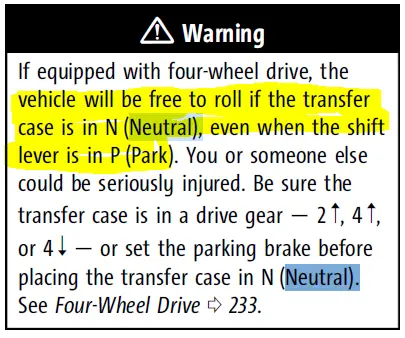

When in Diagnostic Mode (foot off brake, hold push button start for 5+ seconds) and then pressing the 2High button 5 times in less than 10 seconds will show a Neutral Transfer Case Shift begin on the 4x4 indicator on the DIC, but I have not been able to get it to complete and it reverts back in 20 seconds, I have tried rocking the vehicle to release pressure on the gearing but it just won't complete the shift, my guess is, per the manual, that the engine has to be running and the trans in Neutral, I will test that today when I go out, BUT, since the transfer case clearly by the indications on the DIC is initiating the switch to neutral (which as stated above allows the vehicle to roll if the parking brake is off EVEN IF the transmission is in Park) would make a huge difference if GM made the change to software to allow this if the engine wasn't running. Seems easily doable.
Per AXE's post, towing is only supposed to be performed with the transfer case in neutral.

On another note, the transfer case does indeed go into neutral in just a few seconds with the trans in neutral, drivers door open (Car Wash Mode), with the engine running OR not, as long as either the parking brake is set OR you press on the brake pedal. I tested as many permutations I could think of and the bottom line is the transmission has to be in neutral first, so this is of absolutely no use if the engine won't start, way to go GM.
The one thing I did learn is that the drivers door HAS TO BE OPEN before shifting into neutral, otherwise when you open the door it automatically goes back into park.
