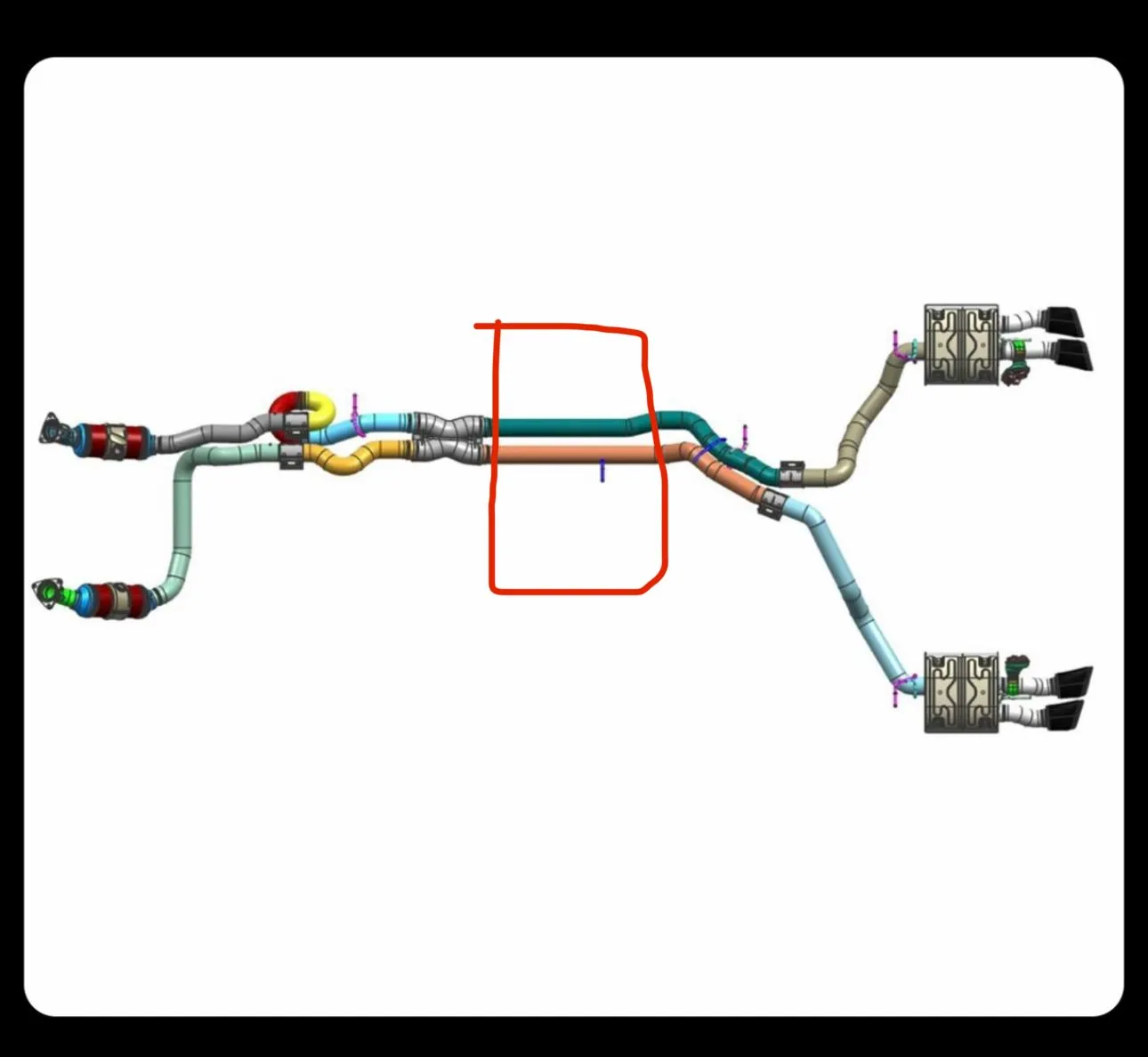

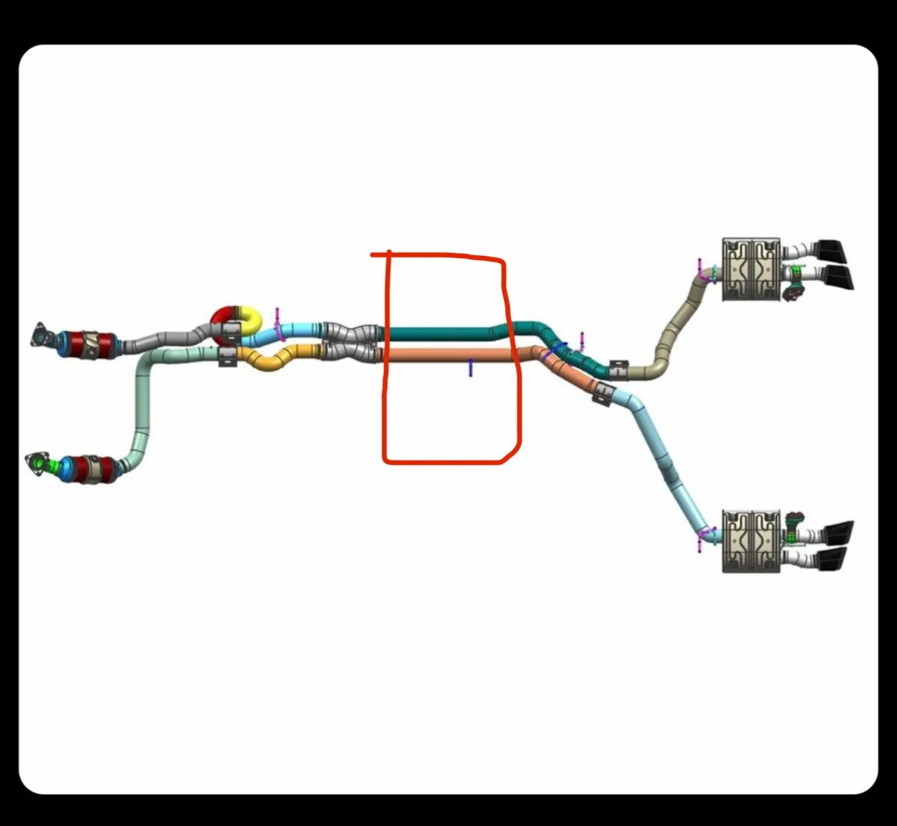

i might have a solution although like you said might be hard to incorporate.
My idea is to mount both stock mufflers vertically in the red area to clear the drive shaft and tuck it much closer to the cab for ground clearance would be nice if I can get my hands on the stock muffler dimensions to test it out with cardboard before pulling the trigger
My idea is to mount both stock mufflers vertically in the red area to clear the drive shaft and tuck it much closer to the cab for ground clearance would be nice if I can get my hands on the stock muffler dimensions to test it out with cardboard before pulling the triggerView attachment 14144

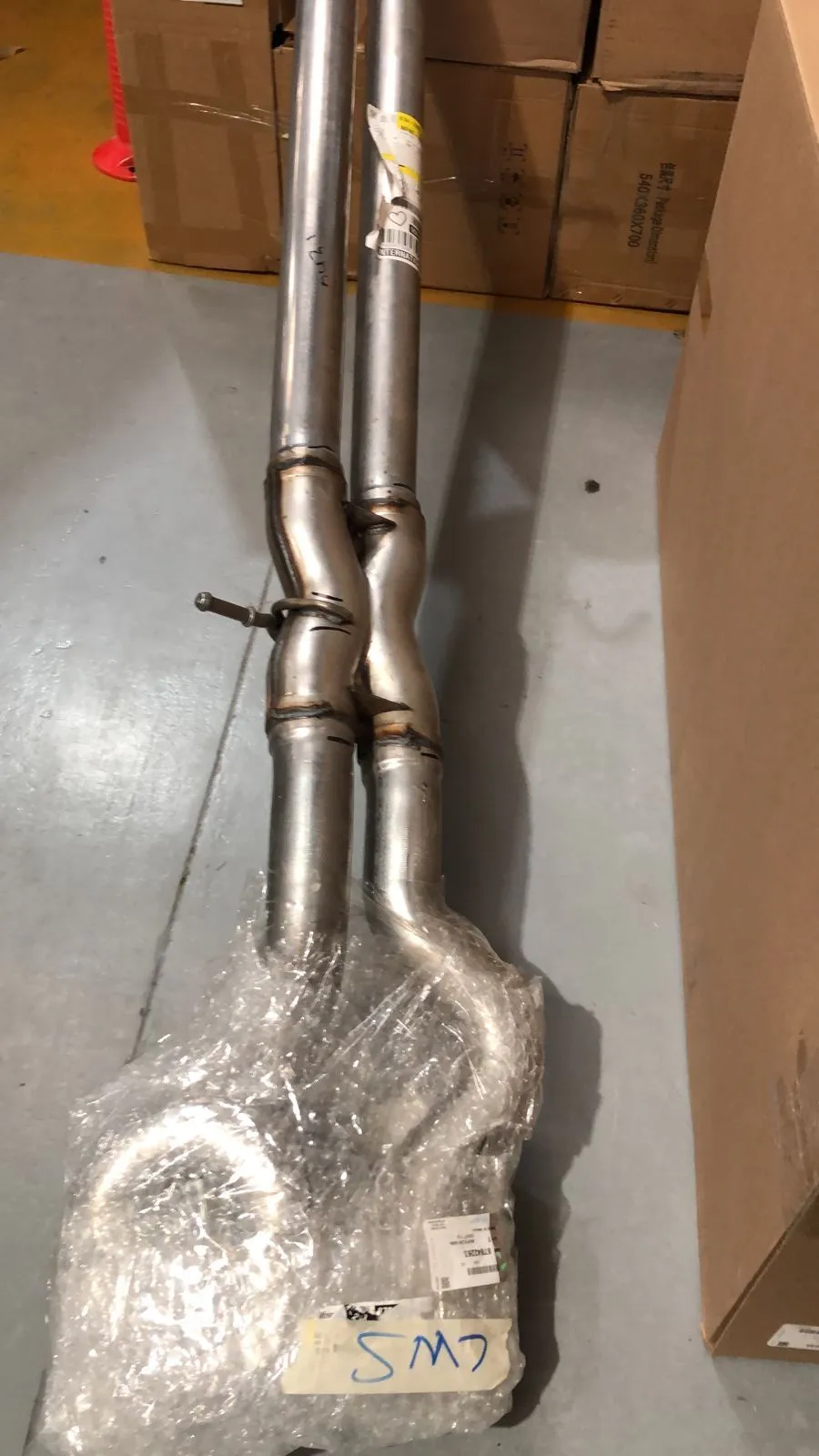

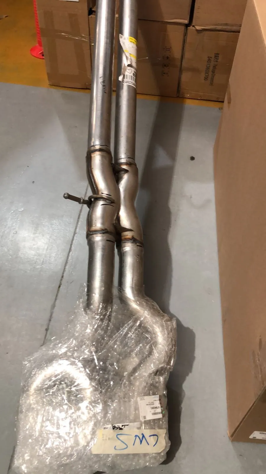

Managed to get the midpipe!

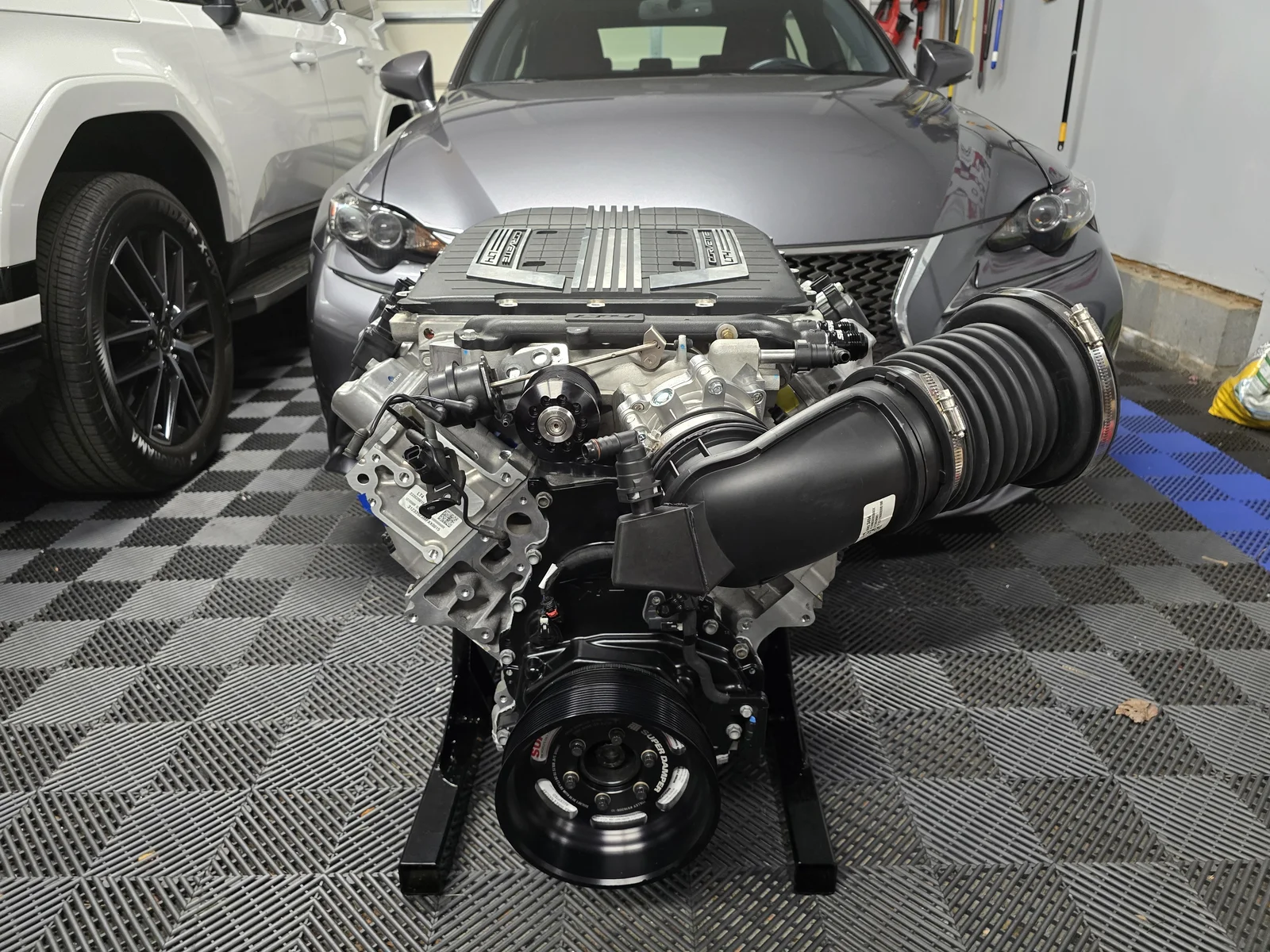

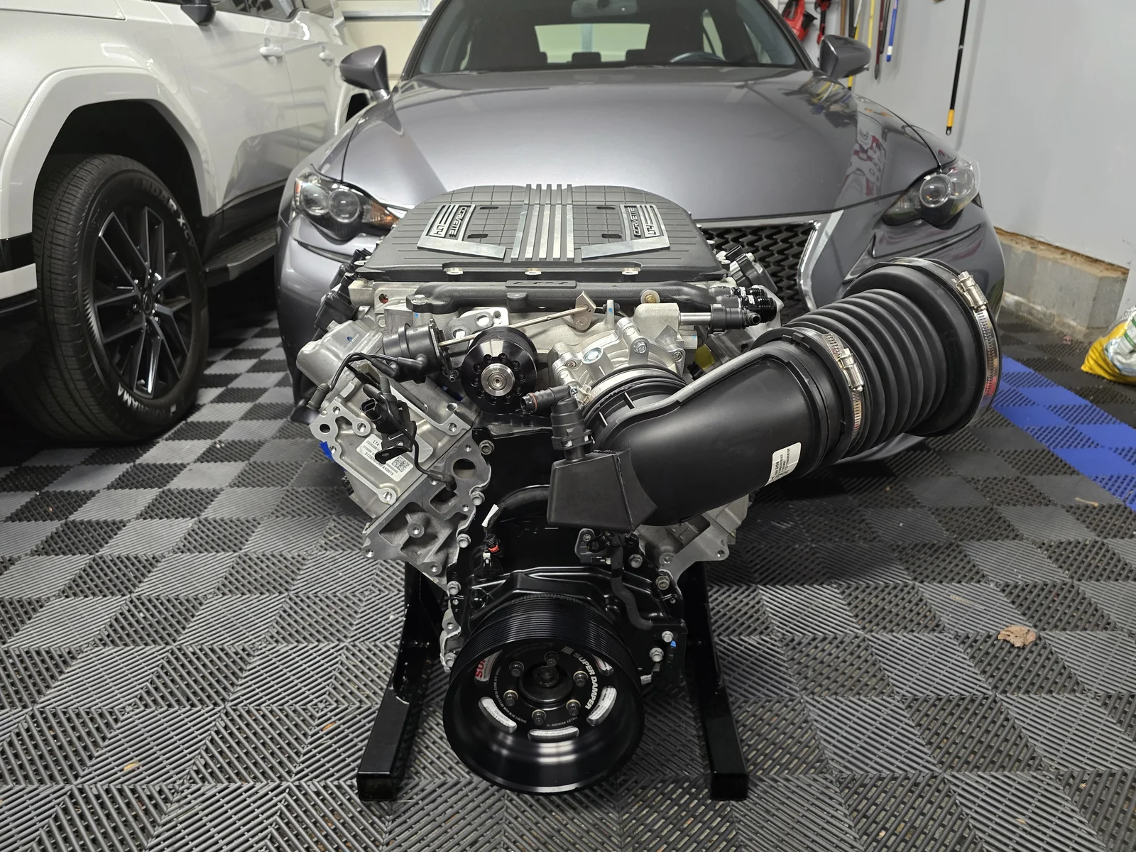

Honestly I need to finish the 427 in my Vette first. After I wrap that up - and if the L87 still hasn't blown up - I might install it then.
If the L87 takes a dump, GM replaces the engine, I would take the truck back with new engine and then swap this in. That's my ideal plan.
