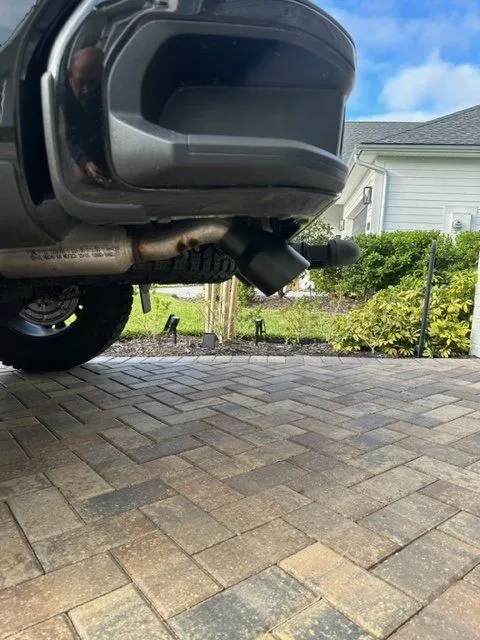

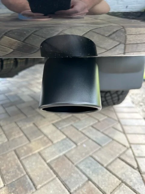

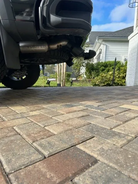

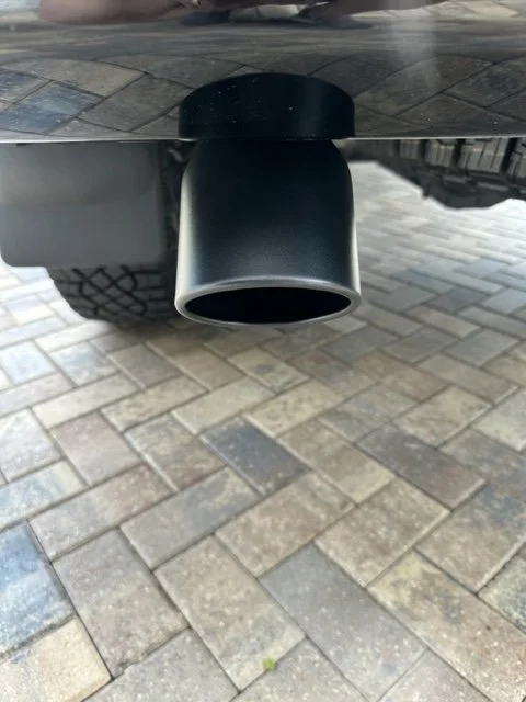

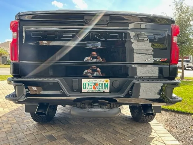

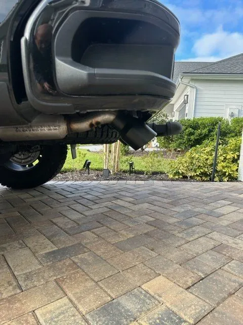

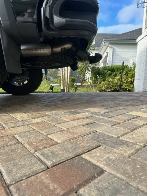

A few of you have pinged me for a side shot and wanted to know how low they hung. Here you go...as you can see, not low at all with a clearance of 17" from the ground to the bottom most portion of the tip. I think they look awesome for a total of around $50!

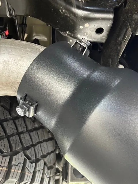

I cut 1/2 inch slips in base and crimped the remaining tabs down closer to flush to stock exhaust tube. Had nice some $8 stainless bolt style clamps, but they were so slick and stiff they wouldn't mate well to out of round stock exhaust tube. Ended up using some cheap Taiwanese worm drive hose clamps and it tightend up better.
We,ll see how they go for $32.

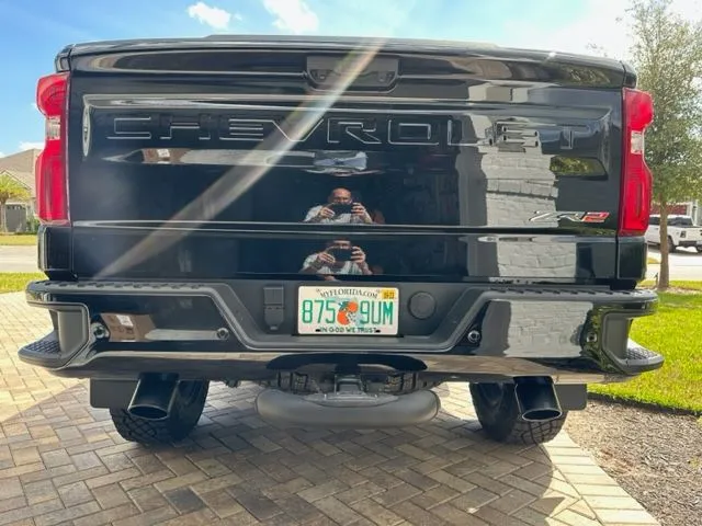

I think the black fits the truck better. IMHO.
I've got black on my Duramax and it looks great. I've pulled it off, cleaned it, sanded out some minor chips, and repainted using header paint. It looks great years later.

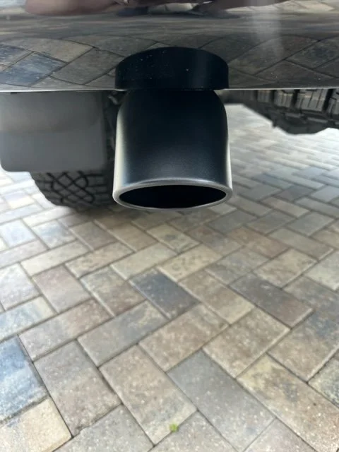

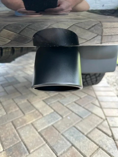

Nice, I just got the same ones, are yours touching the bottom of the bumper? Or space between the top of the tips and bumper ?
