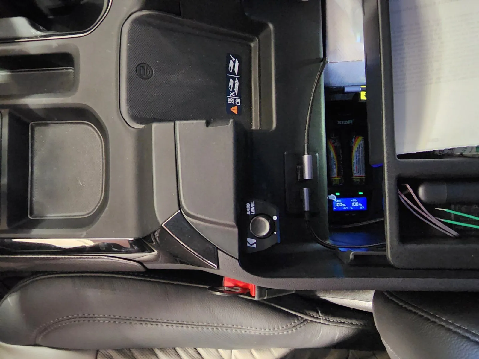

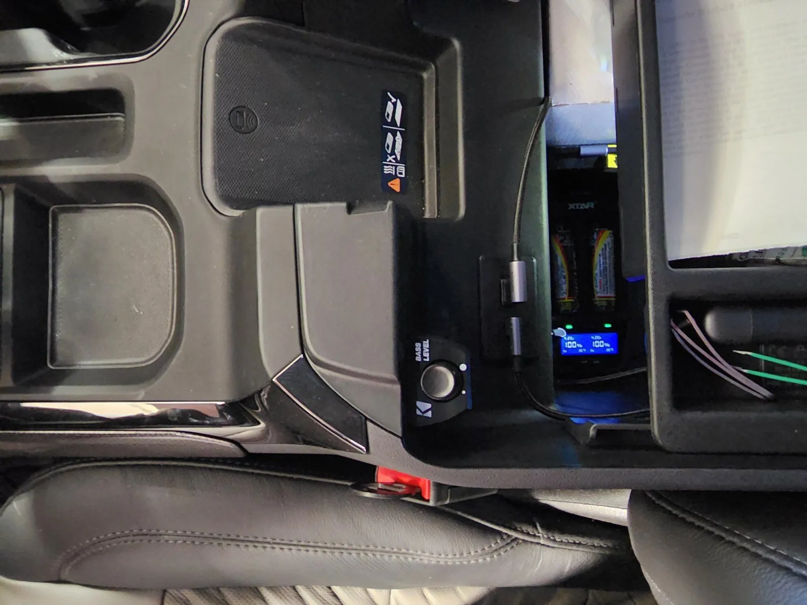

Thanks for sharing, this is on my list of purchases!! Really appreciate it.Just a FYI for anyone with this sub. If you remove the amp by taking out the 4 screws. On the back side of the amp there is a rubber plug. There are 6 DIP switches under it. 1,2 and 3 are gain controls. It comes with 1 up 2 and 3 are down. If you turn all three up it makes a world of difference. You should also add Kicker knob part number 46CXARCT. You can get it on Amazon, eBay, ect. They are about 40 bucks. There is a rubber plug beside the wire harness that covers a 2.5mm jack. The knob plugs in there. If you don't add the knob, but turn the gain up you might not want all three up. Could be a little to much for some songs. I mounted my knob in the center console.
