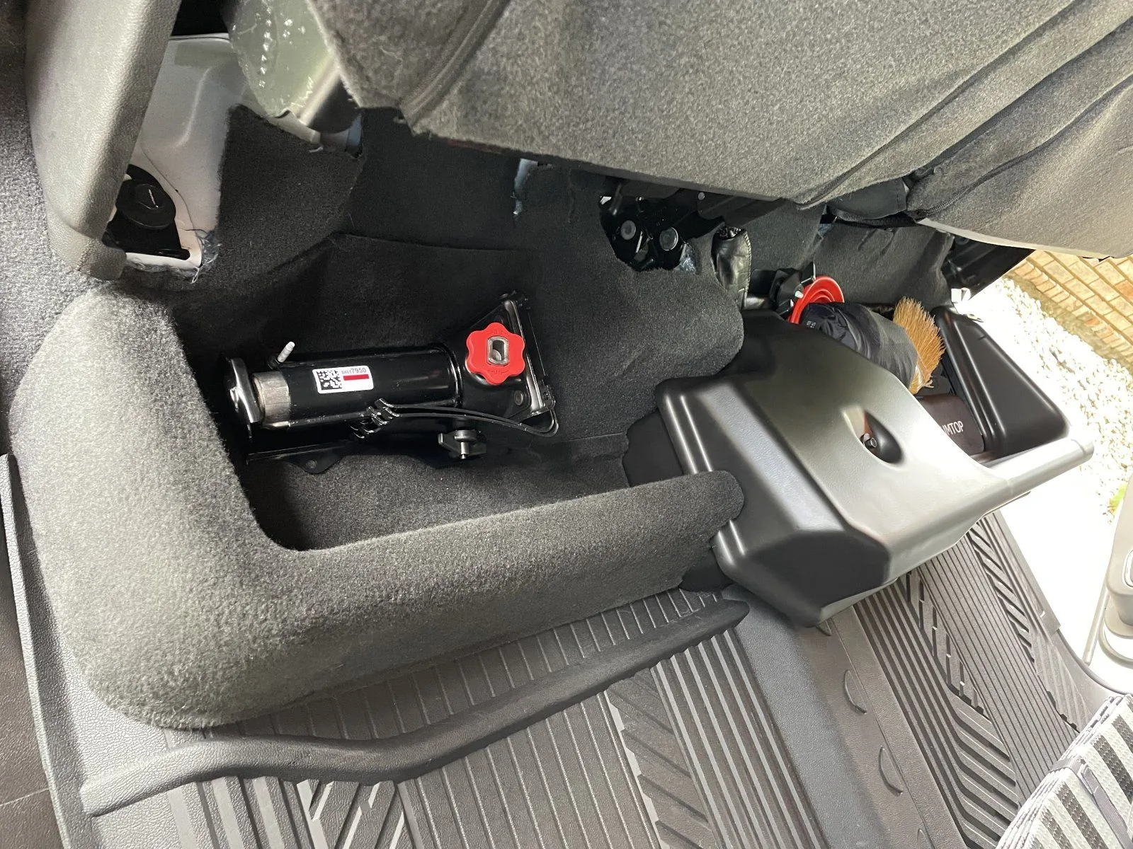

Installed the GM kicker sub tonight and it definitely added to the factory setup. Added the kicker control knob and feel that its plenty of bass for me. Overall happy with the purchase.
Is the install just plug in a conmector and set it in place? Wonderimg how easy it would be to put in and take out? I have 2 Mastiffs that go with me often and I would want to remove it when they are back there with the back seat bottom folded up.
Its attached to the seat bracket with one bolt and another bolt holds the centre as well as plug connectors. It really doesn't take up any more space than the factory storage piece.
