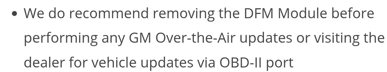

Range says to remove it for any any OTA or OBD II updates, so proceed with caution. I recently did an OTA without issue, I think it was the first one I've had on my 1500. Dealer has done a few others.

Definitely worth pulling the Range Module before OTAs and ECM work.
