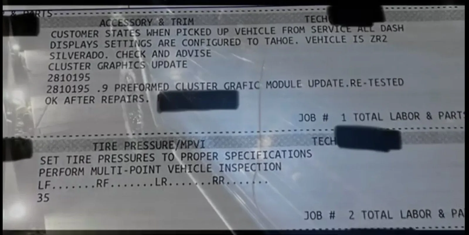

I was doing Chevy ZR2 shit today and didn’t make it to the dealership. That will be a tomorrow adventure and I will push info back to the group. If I can get a service code or any relative info that is helpful to all, that will be included in my response.

This is good info I will bring this video and sheet to my dealer on 1/30 and let you guys know the results.
Hey, new to the forums and this caught my attention as i have contacted my dealership as well. They are usually pretty good at getting information I am looking for. They said it was for the 2023s, but I showed them that owners with the 23 models didn't have it either, but some did. But I showed the video of the guy getting an update on his 2022. if I get any news back, I will surely post it.

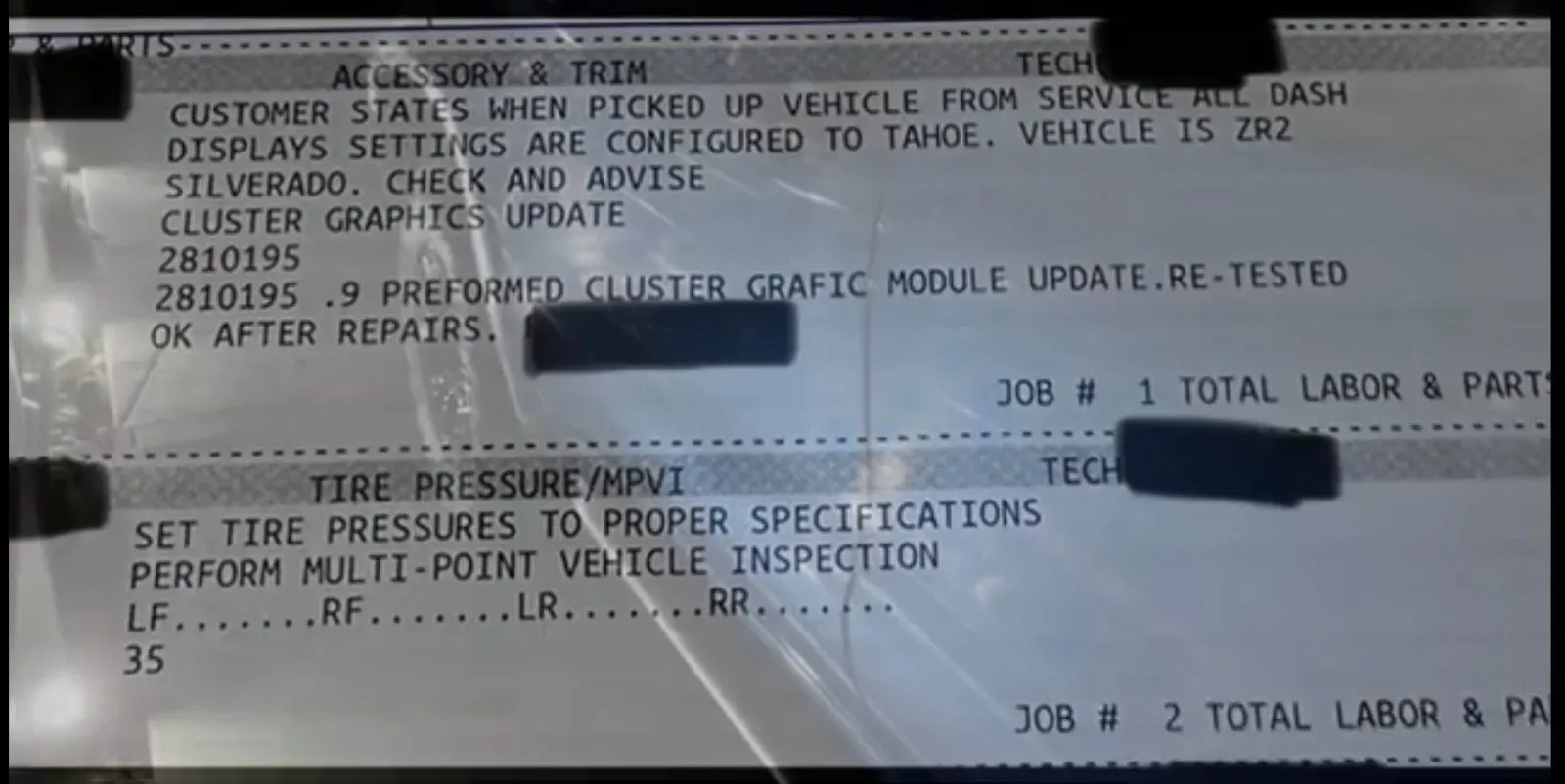

I work at the dealer and had my buddy mechanic look see if there was an updated for the cluster and there was so we uploaded it and made the cluster turn into a Tahoe. He called GM and the guy he talked to said he had never heard about it happening. He gave the option of changing the cluster for s new one. Going to call again tomorrow see if we can talk to someone that might know more.
It's not a new cluster that's needed...you just need the correct file.
