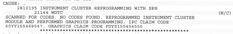

I am not certain if this contains any additional information that would help the dealership identify the update, but am including the portion of the invoice related to the issue from my visit Friday.
My dealer did this while my truck was in for some recalls. I mentioned it to them along with the labor code from this thread, and the tech was able to track it down. The service manager said something similar to what others have posted saying something like "the tech said it was a little tough to find the right file but they got it done".
I’ll see if that works whenever I do take it back to the dealership. One of the managers at Chevy told me if they plug it in and it doesn’t have an update available there’s nothing they can do. But it frustrates me because people are actually getting it done.

Post #125 above has some info from an invoice that might help. I’ve also heard if you tell the dealer the vehicle in the cluster doesn’t match the vehicle you own helps too. The truck in the unupdated display is an LTZ not a ZR2.
That’s what I did… I stated the vehicle in the display was not correct for the model. After install, he agreed and said he was surprised the truck was shipped with the base model set in the cluster instead . …first ZR2 they have had in the shop as well.
