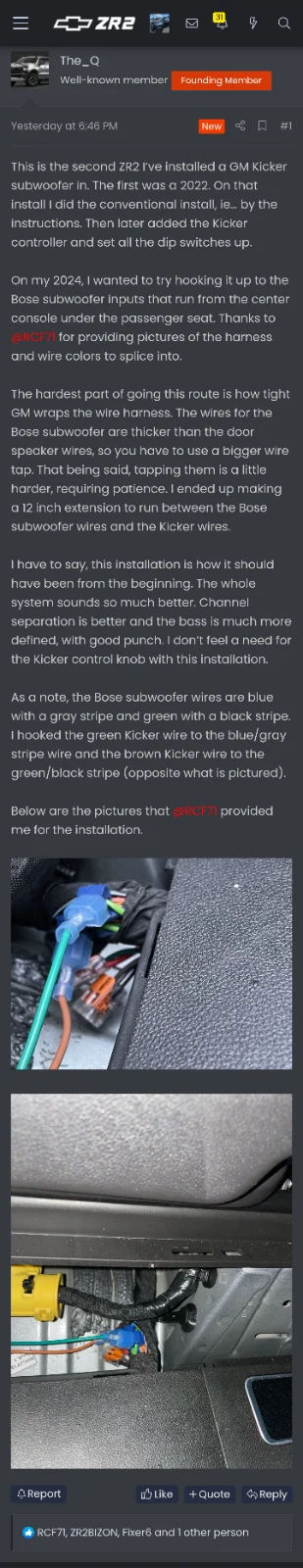

You can get the high level speaker inputs by splicing into the output wires from the Bose amp to the factory sub. The Bise amp is on the back wall of the cab behind the rear seat. You have to take the rear seat out to get to the amp. This post and pictures shows the wires under the passenger seat, but the same 2 wires, blue w/gray stripe(positive) and green w/black stripe(negative), can be accessed at the amp behind the rear seat.
I have had two ZR2s, both with the Kicker sub. My 2022 I connected it as per the instruction provided from Kicker/GM. I used the method above for connecting the sub to the Bose sub channel in my 2024. This connection method by far offers much better sound.
Yep. I think that was your post that I took a screenshot of. I took your advice and hooked up my sub using the sub channel from the Bose amp, except I did it under the rear seat instead of under the passenger seat. Sounds pretty good.
