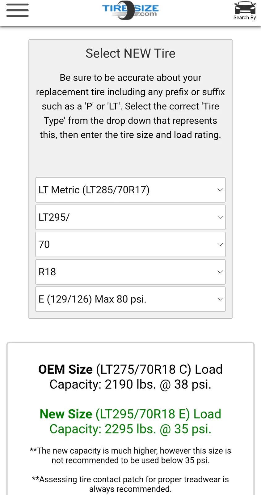

Have you tried out that tire load calculator for PSI? It would be interesting to see if it coincided with what they say, just for curiosity.

I ran mine through the calculator. I'm not sure they have the load specs right on my Toyos (they are 4000 lbs), but it came back with a slightly lower psi recommendation.l than stock I've tested different psi and just went bac to the GM recommendation on the door jam.

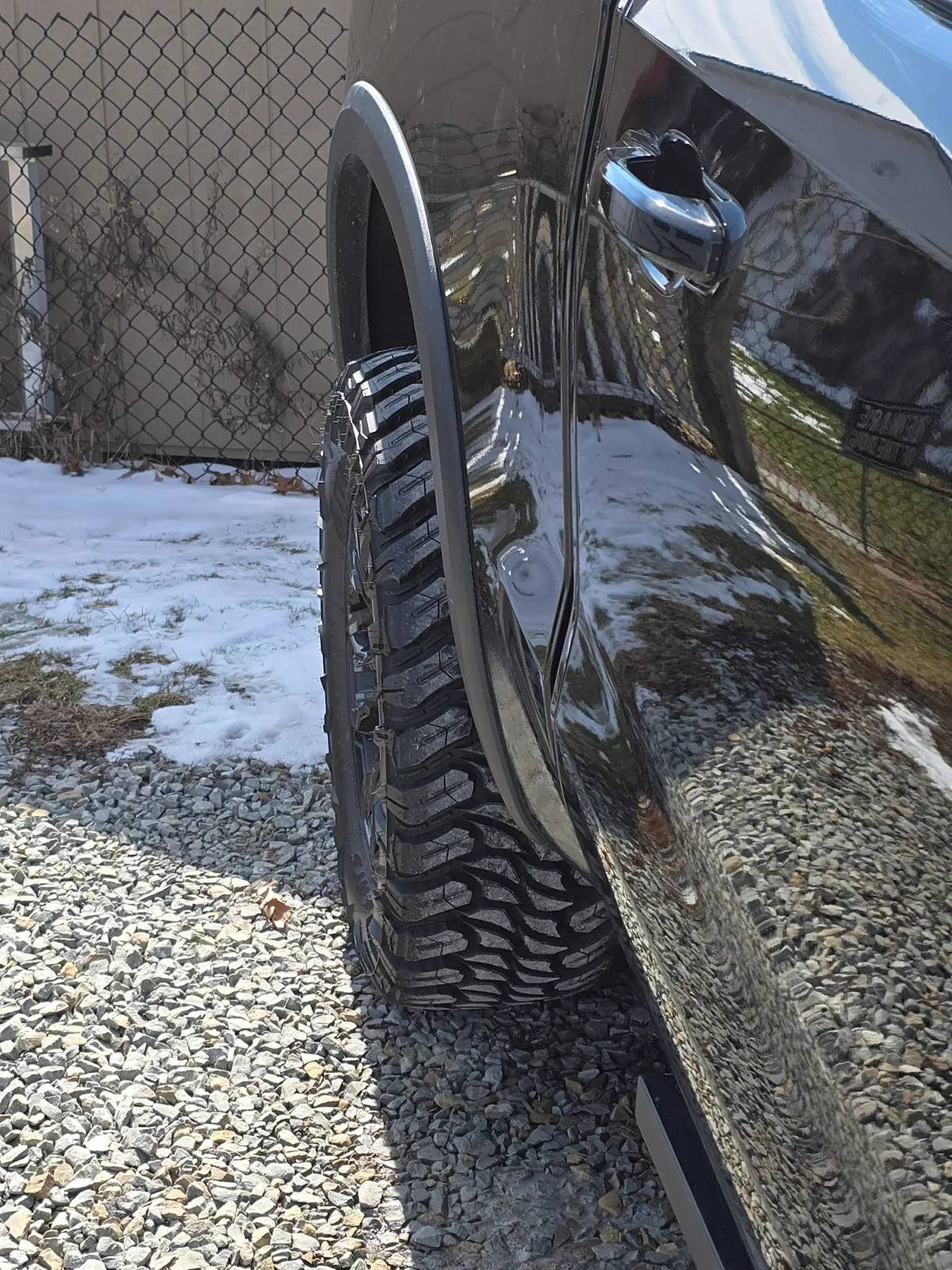

You can go with a meatier tire but I've seen a lot of folks here add some wheel spacers if your not up to change the wheels. Making the stance a bit wider looks 100% better. You can go a size up or wider with the spacer and it looks great. Look around here, should see a ton of info on diff tires. I run the Toyo Open Country RT Trails and like them, but read about the tires guys have. Some are quieter and some not so much. The Toyos seem pretty quiet to me, personal preference. Good luck!
Like this.....2 inch spacers with a meatier tire.

How long have you been running spacers? Have you seen any wear & tear on suspension components at all? I'm stuck because I want the wider stance and I like the stock wheels but have read up on the cons of wheel spacers... so either go with new wheels or stay on the cheaper end and get a set of bora spacers.
Been running the 2 inch spacers for almost 2 years now and no problem whatsoever.
