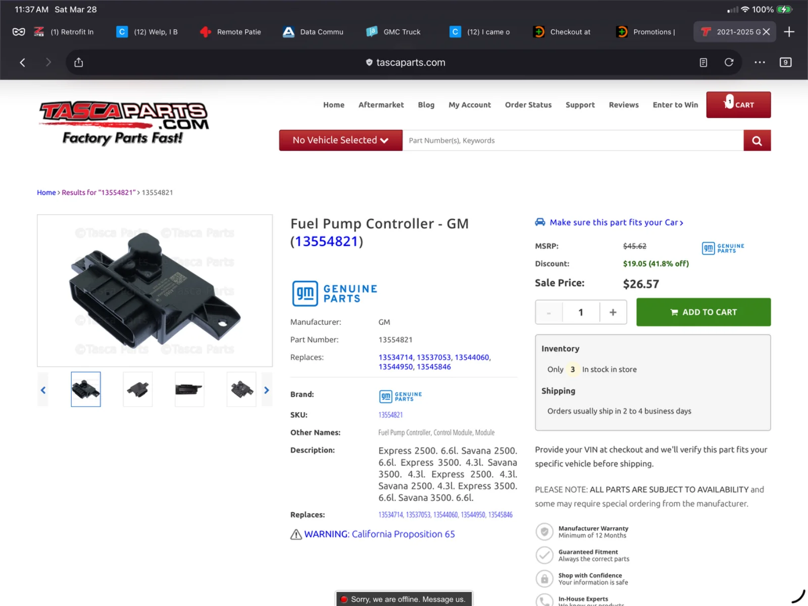

Have one myself in the box in the bed of the truck. Kept it from when I had the 1500.
I’ve got a spare coming from TascaParts.com, with shipping and handling it was about $45.

Damn I have to hire a pit crew too. I knew this truck would be expensive, but not that expensive lol. Ok thanks for the info I'll see if I can find one that fits my truck. where is this module located at in the truck?
Last question. what reprograming does it need to have, I thought it was plug and play?
mine was under a shield next to the fuel tank on the underside of the bed, but I’ve got a 1500… i pulled the battery (-) cable for about 20-25 minutes while i changed the module and the truck picked it up just fine, no programming needed.
Above the spare mounted on a plate off the frame. Fairly easy swap, but you'll need to carry the tools as well. Like @landpilot says, you should kill the power, which means two negative battery cables on the diesel.
