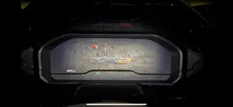

Got the truck back end of day today. Everything is fixed, zr2 startup animation is there, audio in and out issues are gone and i have a zr2 instead of a 'suburban' for the graphics now. Dealer said I had suburban programming. Thought it was a tahoe lol.
