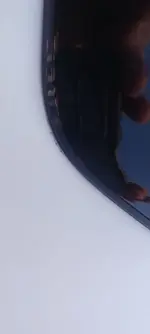

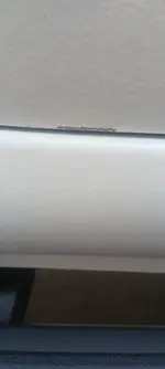

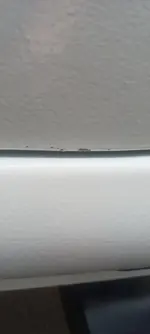

Mine is 9/22 build been arguing with dealer about it. They sent me to a body shop and when they got the 5k estimate back they said they or gm wouldn't pay that. Paint coming off all 4 doors and hood noticed it at 400 miles
If your dealer doesn't have a body shop, you need to go to a Chevy dealer that does have one. GM is very weird when it comes to getting warranty handled by an independent body shop.
Take it to a Chevy dealer with a good body shop and have them write it up for warranty. You can show them countless threads on peeling paint on these trucks if they try to say it's not a warranty issue.
