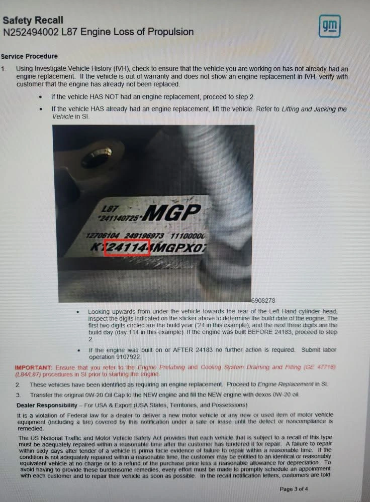

****6.2 RECALL HAS BEEN RELEASED*****TSB NEEDED
Found this. Not sure if it’s been posted already. https://static.nhtsa.gov/odi/rcl/2025/RCLRPT-25V274-1598.PDF
I called this months ago! I suspect they figured it out a long time ago, that's when changes were quietly implemented to newer motors. But they didn't cop to it until customer complaints to NHTSA.
"Engine teardown analysis identified two primary root causes, both of which are
attributable to supplier manufacturing and quality issues: (1) rod-bearing
damage from sediment on connecting rods and crankshaft-oil galleries; and (2)
out of specification crankshaft dimensions and surface finish"
