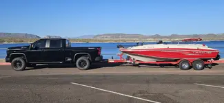

I've done several trips now with my utility trailer and now my boat. The bags do a good job of keeping the truck close to level and maintain a comfortable ride.
What I've found different with these bags is the fact that I run quite a bit less air than my previous lifted 2500HD. I think that is due to a more progressive rear spring and less distance between the frame and axle.
With just the standard 5 psi in the bags I get about 1.5 inches of sag. 10 psi, about 3/4 inch and 15 psi about level. 5 psi leaves too much bounce in the rear, 10 psi is better, and 15psi is a little stiff. I end up using about 12 psi and it rides perfect and has about 1/2 inch sag. It's nice to be able to make those micro adjustments to dial it in just right.
