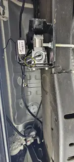

I'm not sure, but if you look at my install photos, there are platic caps on the jounce base plate over the top of axle. Those have to be removed to get the clearance you need. So the bags sit on the metal base welded to the axle which is same as standard HD trucks.

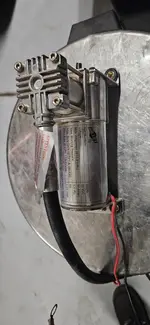

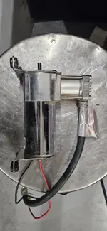

I had my air compressor from the Wireless One kit go bad already. I went to air the bags up and no reaction. Checked fuse and it was burnt. Change 20 amp fuse and it blew right away. Changed to 30 amp, didn't blow right away and I could hear the compressor make some faint noises, then it blew. Jumped wires directly to battery and heat the same noise. I knew it was fried at that point.
I called Air Lift tech support and was on hold about 20 minutes. They basically said it was shot (no shit). Then told me I needed to file a claim on their website. I did that and needed to provide proof of purchase. Two year warranty if customer installed, four year warranty if you have a shop install. I told them that was bullshit cause I do better work than any shop I've ever seen.
The second day, I got an email that it had shipped and got it a few days later.
It was just the compressor which had to be swapped to the c Wireless One chassis. Wasn't hard, but a little hard to do when mounted tonthe truck frame.
New one works, but they seem like some low rent shit if they don't last 6 months. My last three lasted forever and the truck my boy drives is now 11+ years old.

I might do an autopsy on this one and see why it siezed. Maybe not enough oil.

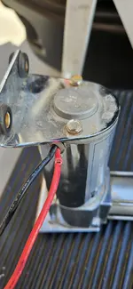

I haven't had the issue with my new pump coming on briefly and frequently. I think it was due to a bad wire. I got to looking at the old pump and I figured out there was damage to the wires about 1/4 inch from where they exit the pump (see photo). The positive wire seems to be cut through and possibly broken. I could make the pump work intermittently by moving the wire, but that would need to be addressed to be reliable.
I am almost 100% sure this damage was done during manufacturing or packaging as the cuts align almost perfectly with the base of pump. I think they were folded over the base when packed and then pushed hard and cut through.
I don't think it was anything I did with respect to install, as I can see in my original install photo (circled in yellow) that the wires exited perpendicular to the motor and away from the pump without interference.
May want to double check the wiring from pump and manifold harness when you pull it from the box. Probably a rare occurrence, but would have saved some headches.
I might see if I can fix the wire and keep the pump as a spare.

Definitely looks like a packaging issue. Have seen this before on electronic products purchased for work.
