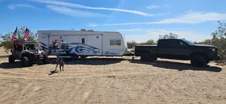

Can you even tow 10,000 lbs with that little gasser? You could stick a couple cantaloupe under the frame and tow max with that setup.
Haha, My Toyhauler is 11,400GVWR and the gasser handles it great. It has 1500# tongue weight. My tractor would put my 1500 completely on the bump stops. Which was why I had to figure out bags for it immediately. On the HD that same setup is NP with out bags. I don't regret the gasser at all. It's been great and since it's my daily driver it get's drove around town unloaded often. The no throttle lag and the 900lb lighter is great for that. I believe it's 16k tow rating. I'll never pull that much with it, But I bet it would do it. I seem to usually live at that 12k or less number though. Which is why I got it. Everything is always a bit much for 1/2 ton but np for a 3/4. A skid steer, mini ex or my toyhauler is about the heaviest stuff I'd ever need to pull.
I'd have a smaller Toyhauler if I could. Not cause of the truck though. Sometimes we go for a week, Often we drive a few hundred miles each way for just a weekend trip. Smaller camper is easier and fits in more places, But I have to have at least a 12' full width garage for this SxS. So a 34' is about as small as it gets. I'd never want a huge fifth wheel for what we do.

If your running that variety of trailers, that's the exact reason I run bags. They work much better on the variable weights and trailer designs. I run mine at 20 psi for loads under 6k and ramp it up to 70-80 psi for loads over 12k, depending upon road and driving conditions.
You'll be surprised how much better it tows with just a little extra support from the bags. My toy hauler maxes out at 13.5k ish and I'm usually under 13k on the scales. It sags worse without my sxs loaded cause of the forward weight bias due to trailer design. The most I've towed was probably around 14-15K with a Bobcat 770 and some attachments. I would have hated towing that without bags.

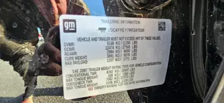

The thing with lifted trucks is that the added height levers the trailer weight higher on the rear axle than a normal height truck. If you run your truck across the scales, you'll likely be suprised at the weight on the rear axle.
Here is an example from my most recent trip to the dunes. You can see that my trailer is well below max and my normal load of about 12.5k,, but the rear axle is getting close to max and only 400 lbs off. I had a few hundred pounds off gear in the bed. Truck sat very level and I was running 75 mph with 80 psi in the bags cause of some choppy pavement.
This is consistent with my 2005 and 2015 2500HD Duramax that had 6 inch lifts and similar ride height. Ran the same set of bags on those rigs.

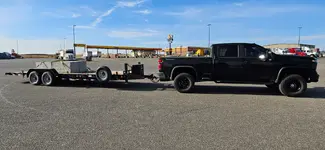

In this case, i was towing some 2000 lb concrete blocks. You can see by the weights of the truck only vs truck and trailer, I had 1980 lbs on the rear axle, so technically overloaded with a 12,780 lb trailer running 23,640 gross. No WDH, running 80 psi with blocks right over the trailer axles.
Bottom line, run your rig across the scales, or you'll never really know what your towing.
As a note, these 16:9 phone photos always make the truck look like its sagging, but it is always pretty leveled up with bags.
