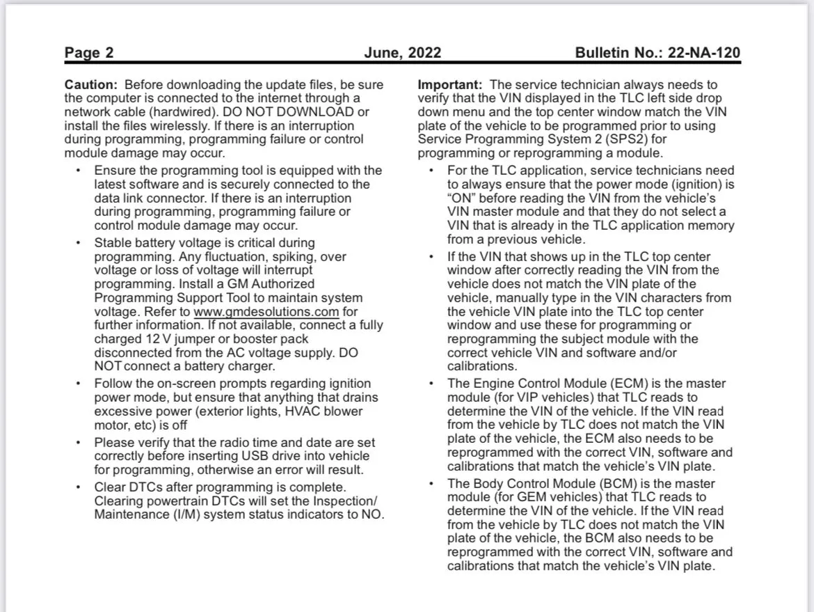

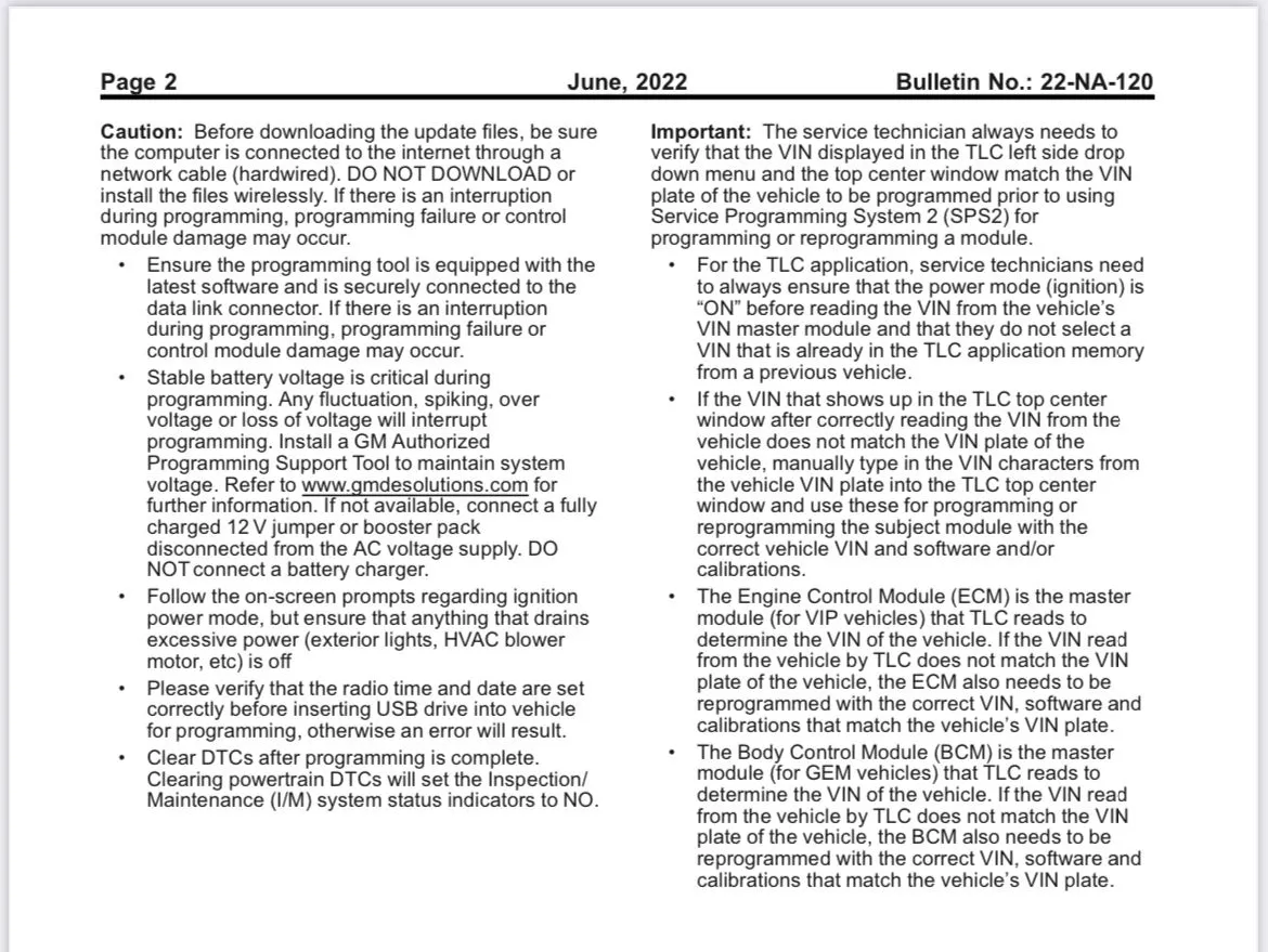

i sat at my dealer for 2 hours waiting on this update. they went wireless and it failed. now manager says i need i notification from GM or i can pay $85. blow me!
It CLEARLY tells them NOT to do the update wirelessly in the bulletin 🤦🏼‍♂️ Thankfully, sounds like they didn’t brick you cluster doing it the incorrect way. I’d find another dealer that has a tech that can read.
