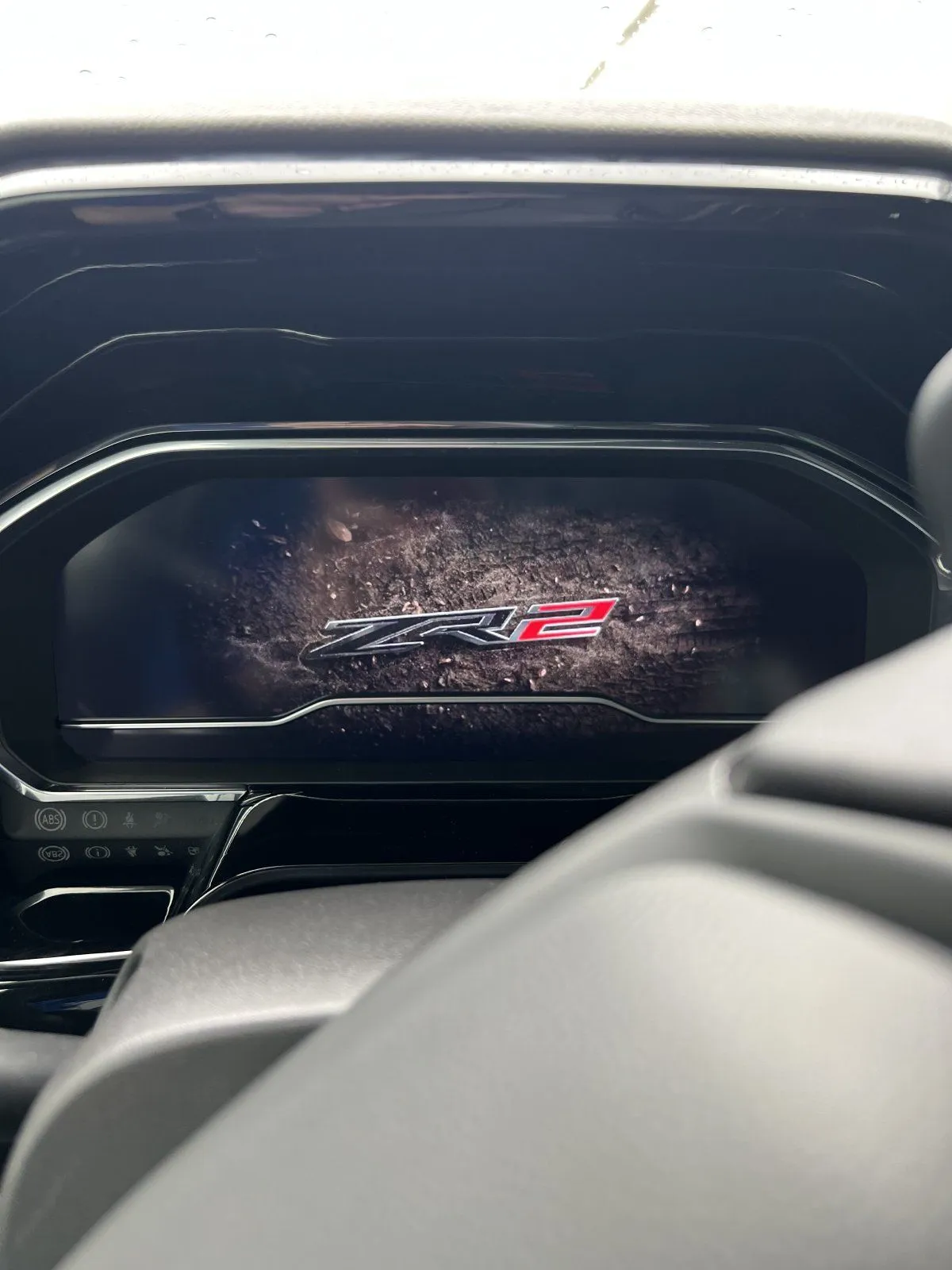

Ok definitive answer on the ipc update. The calibration file for my truck has changed. I installed the graphics calibration then the programming calibration and I now have a zr2 on the dic.

Well the dealer finally agreed to see if they could fix this, dropped the truck off yesterday AM.
Got a call in the afternoon, they were able to get a TAC Team? to help with the issue, but now the dash display is of a Tahoe! LOL! At least they are on the right track, gonna attempt it again tomorrow!
Stay tuned!
Turns out the DIC is the wrong part #, they had to order a new one that will accept the ZR2 logo....

Yea I did, 24 year gm master tech on my own truck I can tell you they programmed it wrong if you have the Tahoe now for sure. Replacing the ipc will fix it because it will force them to program it correctly…
If the dealer struggles to get the correct image variant then they are not programming with the correct calibration most likely. The graphics software containing the ZR2 assets was released over a year and a half ago. Any parts past then would have shipped with the correct graphics software in order to be calibrated for the welcome animation and enhanced drive mode indicator. There were 3 cluster variants: chevy/gmc truck, chevy/gmc suv, and suv denali. Sometimes they order the wrong part, or don't perform the initial programming correctly. And then sometimes they still manage to brick parts. But the OTA team should have rolled out these updates ages ago, they were always so far behind in campaigns. Source: former gm cluster engineer.

Update! The new DIC fixed the issue!
