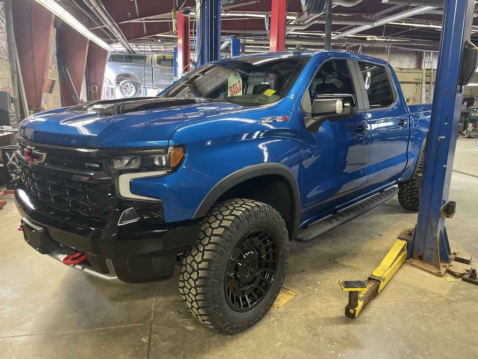

Fuel Siege 18x9 0 offset wheels, 2”leveling kit, 2.5” rear block (stock is 2”) and 1.25” wheel spacers.

Spacers were G2 Axle and Gear. You will need to grind about a 1/4" off the wheel studs, so they don't hit the back of wheel.
Leveling kit was a Motofab 2" (part# CH-2).
Any change from the Factory Ride after the level kit?
I have just added Nitto Trail Graplers at 295/70x18 and I think you can not go any larger stock without trimming. New tires improved handling and ride...
You are running these on the factory wheels correct? Do you have any pictures?
Did you have to do any special fabricating or cutting for the level to work. Did the control arms still clear once you installed the level?
I'd like to know this too. From what i've seen on YouTube replacing the control arms is pretty much a must with the leveling kit. I am not finding that they rate any for ZR2 specifically yet.
