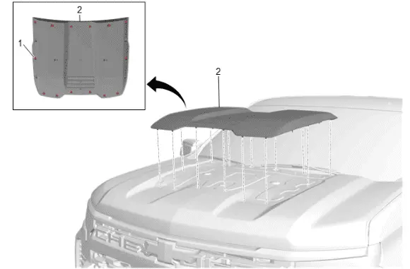

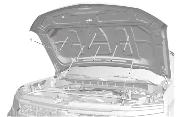

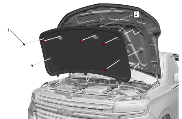

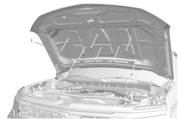

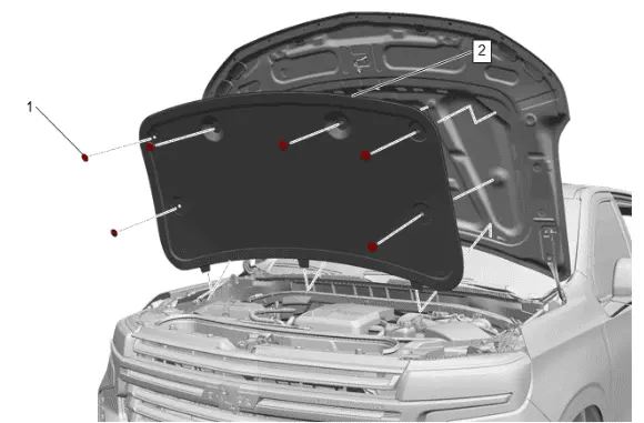

1. Hood Insulator Retainer (1) » Remove [6x]
2. Release the 3 integral tabs at the bottom of the hood insulator.
3. Hood Insulator (2) » Remove
4. Hood Center Molding Nut (1) » Remove [8x]
5. Apply two layers of masking tape to the painted surface surrounding the hood center molding (2) to prevent paint damage.
6. Using a suitable plastic trim tool, carefully release the [14x] hood center molding retainers (1).
7. Hood Center Molding (2) » Remove
Reinstall:
  1. Hood Center Molding (2) » Install
  2. Ensure all of the hood center molding retainers (1) are fully seated. Hand tightened, not too tight.
  3. Remove the double layer of masking tape around the perimeter of the painted surfaces.
  4. Remove any remaining adhesive residue with a 50/50 mixture by volume of isopropyl alcohol and clean drinkable water. Wipe the surface dry with a clean lint-free towel.
