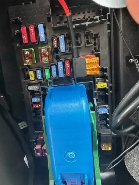

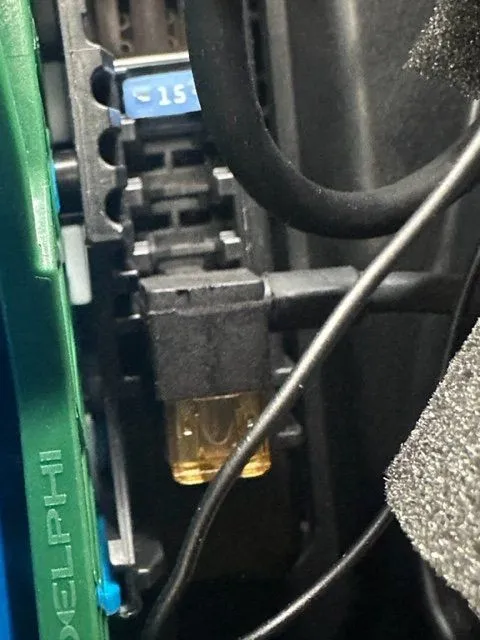

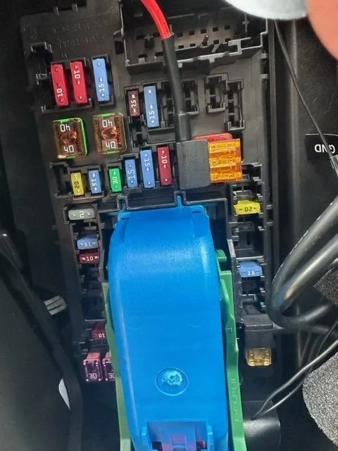

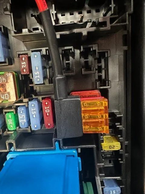

I hardwired my radar detector into the fuse panel and installed a Blendmount on the mirror stalk. Very sweet! You can also buy a cigarette lighter plug and hardwire the same for your safety light.

There are two fuses on the passenger side fuse panel...easy to access and tap. I can take another look at mine and share which fuses I tapped for constant 12V and switched 12V. You will need both for a dash cam and only switched for a radar detector. You can always order fuse taps from Amazon...they have every type under the sun.
Perfect, this would be super helpful. If they're both Micro2, I'm set. If it's Micro3, it's off to Amazon I go. :)
Where did you ground to?

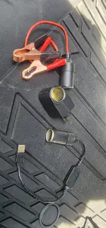

I just use this and works fine
It only supports 8W which may not be nearly enough to support what he wants to connect, but interesting nonetheless. Thanks for sharing.
Well works for my beltronics radar detector so should work for most others
