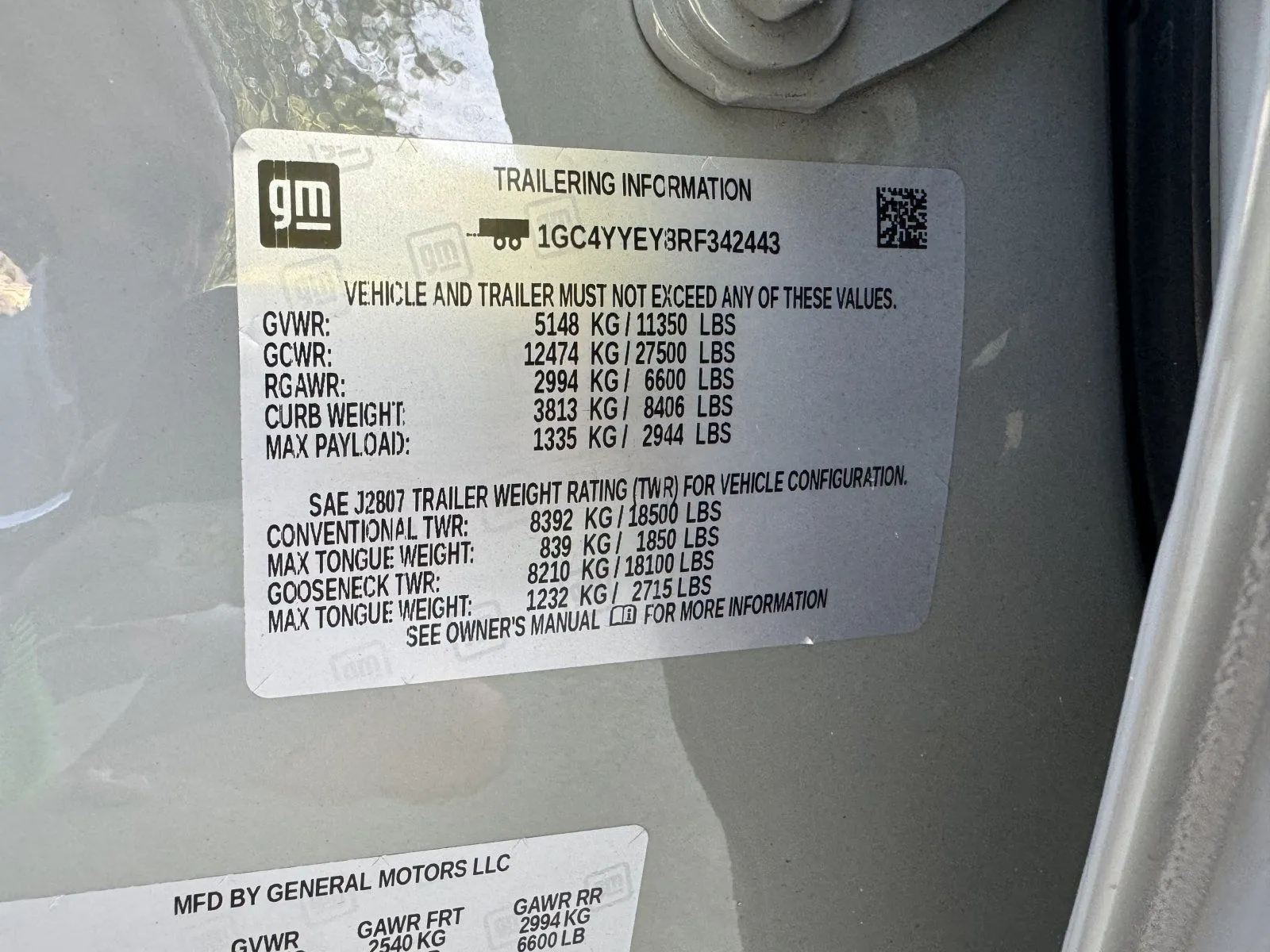

Yeah, me too. I don't understand the whole leveling deal. Mine is sitting leveled or squatted some pretty often, lol. I was just wondering if cranking them up to much was the culprit. Glad you said something, I will keep a closer eye on mine. If I remember right, I think there is about a 700lb difference on curb weight between the 6.6 gas vs the diesel. My curb weight is 7,517 with sunroof and multiflex tailgate. You wouldn't happen to know curb weight on your Duramax would you?
The Bison package adds about 300 lbs. So I just say 9000 lbs for the diesel with the gear and tools and accessories installed.
Wow, 8406 vs 7517. So it's more like 900lb difference. With that 900lb difference up front. That might be why they are working on mine, but not on yours. That's a pretty significant difference. Still odd they are compatible with a AT4 or high country Duramax, but not a ZR2.
Non Bison ZR2 8482 pounds my tag says . Mine does have the factory Power running boards maybe they add a few pounds

Side note it is kind of interesting on the numbers looking at the different ones sise by side. My Gasser has the same axle ratings, more payload, but slightly less GVWR. 11350 vs my 10850, which is only 500lbs even though the curb weight difference is 900lbs apart. Max payload on mine is 3333 vs the around 2900 on the Diesels. Around 400lb difference in payload since the GVWR is 500lb higher on the diesel. I guess to help offset that 900lb weight difference.
The Diesel has higher conventional tow and tongue ratings, but lower available cargo capacity. While gooseneck ratings are the same with gas and diesel. Kind of funny the max gooseneck tongue weight is only about 130lb less than max cargo capacity on the Diesels.
I have the snow plow prep package , also ordered the hard folding bed cover even though it was installed at the dealer maybe they included that weight .
I wonder where the weight difference is? I have every other option???
I'd say snowplow prep package if I had to guess. If you notice it increases the front axle rating also. That's why mine and his has a 6k front GAWR.
