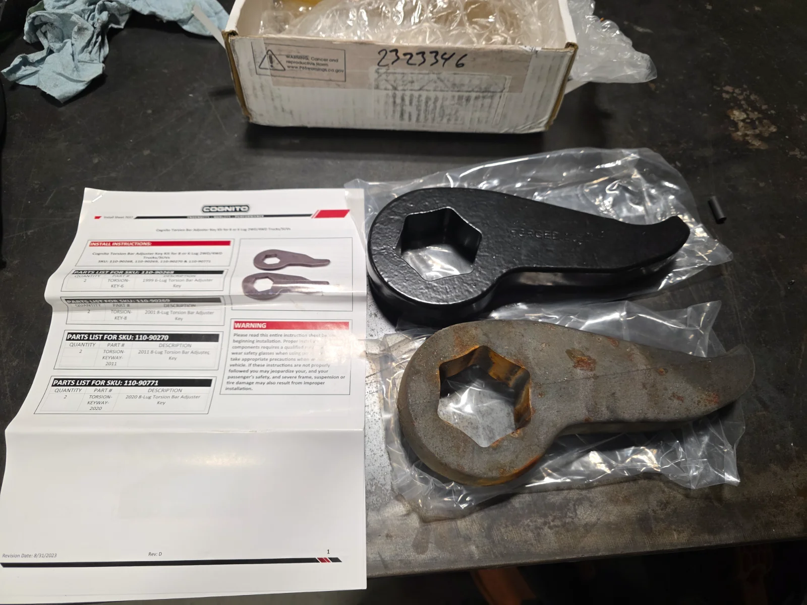

did you have to crank the keys more to get the same height? I imagine so. did you have to use "level" keys? how did the ride end up?
I didn't change out the keys. I probably will though. I emailed Cognito yesterday about it actually. When I got mine there was no mention of ZR2 trim. Not long after i got them, their website changed and said not for ZR2 HD or AT4X HD. Now their website says they are for a ZR2, but you need to change the keys also, lol. I just left mine on the whole time. I did have to turn them up more then stock bars when I 1st installed them, but the ride quality was still noticeable better on mine over stock. I probably will try the different keys just to see how it does. They are pretty easy to change as long as you have one of those tools. There was a couple other guys on here with the same bar.
BTW Cognito did get back to me. They said to use these keys, Part#110-90771. I got around to swapping them out today. I actually had to back the bolts off more then the original bars and keys for the same ride height. So with these keys you definitely don't need to crank them up more over stock. Haven't drove it that much, so can't say if they make any difference. They look pretty compared to stock though 🤷‍♂️ , lol.
pretty sure those are the exact keys i have. i haven't swapped them yet, will probably do them and torsion bars in the next couple days. i have only done the rear. first i tried the congnito add-a-pack because i did not want to deal with removing leafs. they were better, but not great. so i bit the bullet and did the full cognito leaf swap. the ride is better, as good it will get unless i try sulastic shackles. (i had both the add-a-pack and leafs from a previous build)
I Tow a fair amount, so I didn't want to soften the rear suspension any. I actually added AirLift 5000 ultimate kit to mine so I couldn't stiffen it up some when needed. Stock was fine, but definitely wasn't too stiff. I have a bed rack, metal roll up cover and I always have stuff back there.
But my truck had plow prep package with 6000# front GAWR. The included torsion bars were 84745489. Which from what I could gather is the same bars that come on a Duramax with a plow package. Duramax is 900lb heavier in the front end, lol. A little much for my truck that will never have a plow and the lighter engine. That's why I went with the comfort ride bars. They made a very noticeable improvement on mine even with the oem keys turned up. Tows and hauls the same. Just doesn't bunny hop and beat you to death on big bumps now. Still rides like a HD, but is what it is.
