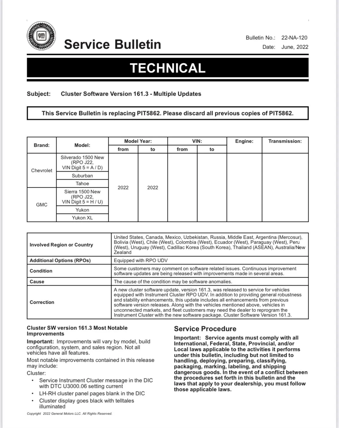

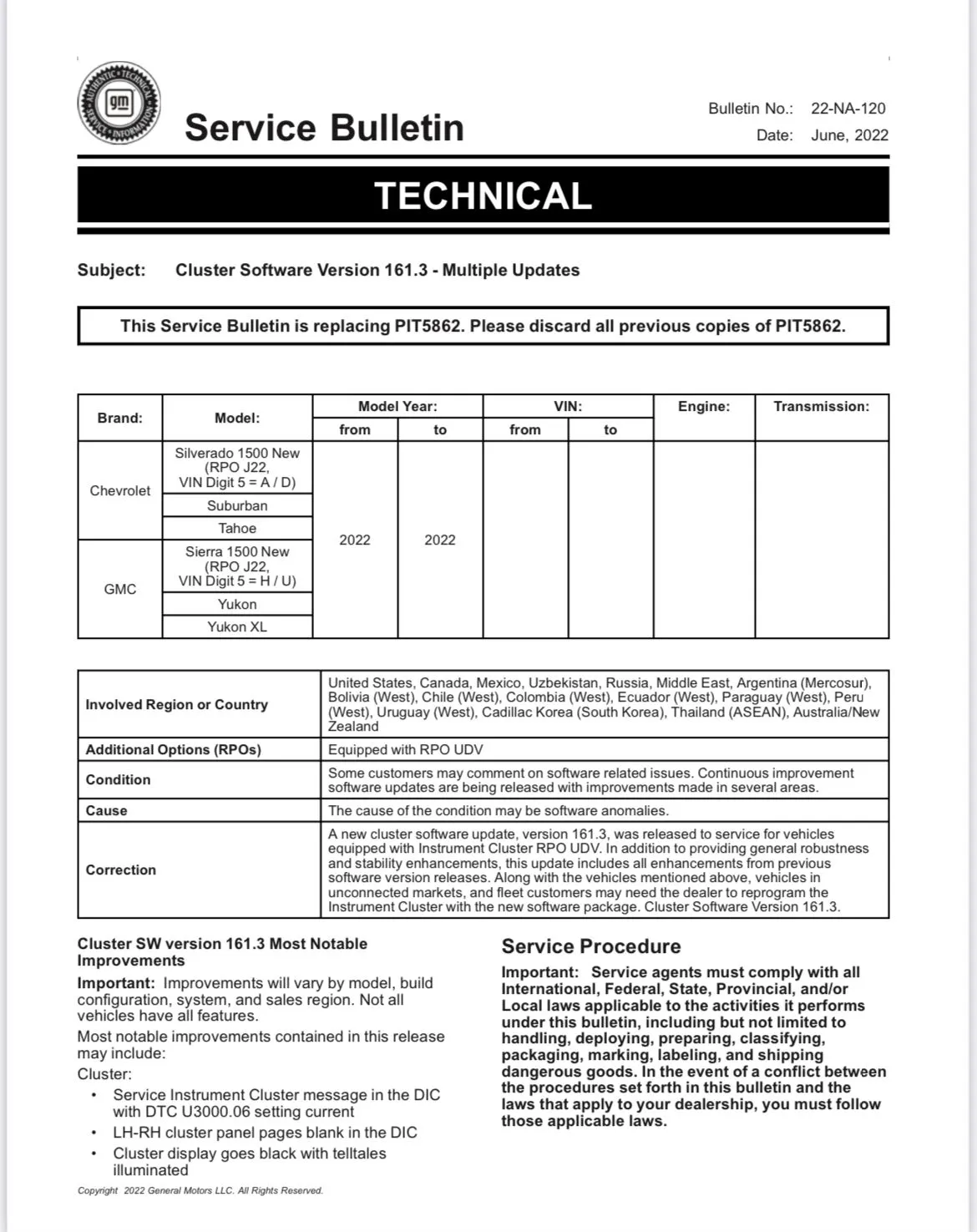

Tell them that the truck in the cluster does not match what you own. The truck in the cluster is an LTZ not a ZR2. Also, there is a service bulletin for the cluster update which I believe pays the dealer to preform the update (see page 6). The bulletin number is 22-NA-120. It’s about 6 pages long. The very important part of the bulletin is the “must be preformed with a wired connection”.
