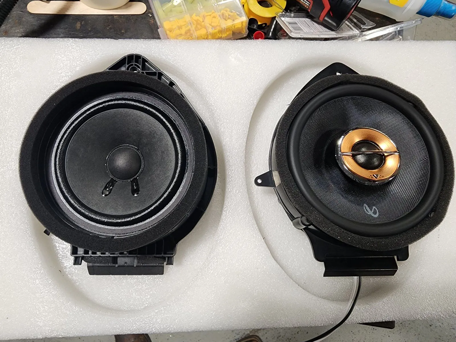

Factory Rear doors are 3.6 ohms. So front doors are 2.0 ohm. Dash speakers are 3.4 ohm. Dash speakers are 2.75". Front doors are 6"x9". Rear doors I guess are technically 6 1/2"" by the enclosure. I'd say the actual speaker is more like a 5 1/4" though. Here is the factory Rear beside an aftermarket 6 1/2". The actual speaker on the aftermarket is obviously larger. The speaker plug adapters for a 21 chevy silverado with bose works even though it's not listed for the refreshed models. Polarity is also the same. HTH
