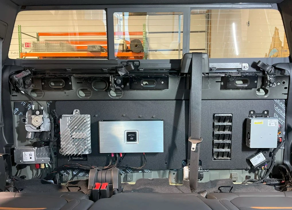

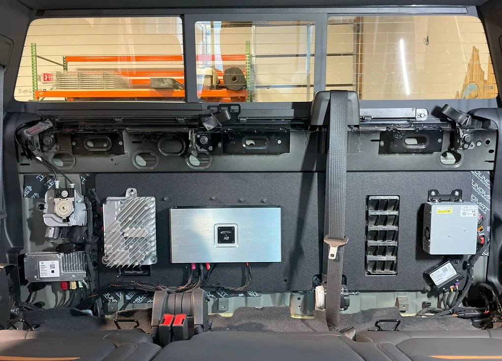

From what I've ready, keep everything flat and still use an external DSP amp like the AudioControl amp I'm using, and then do the tweaking in the better DSP. I went and bought 2024 Sierra Denali 3500 Dually which has the exact same setup, so I'm gonna do the same setup as my 24 Silverado 2500 but I'm gonna use this adapter package and see if I like it better.
Also, gonna use this panel to mount everything...much cleaner than what I did on my other truck. I'm learning from my mistakes, and you can too!

Just a heads-up, I see that there are some recently available options for getting good signal from the system and bypassing the bose amp. The AXDSPX-ETH1 from AXXESS includes DSP and T-Harness with all integration, which means you unhook the BOSE amp entirely, plug this in to the appropriate plugs, and it outputs pre-wired and ready to plug in for the front dash, door, rear door, and sub. So, you would only need to hook the amp up and plug it in, no tapping into the wires to get from speaker out on the amp to the speakers. It also apparently does the work of getting the signal to the right places without requiring summing, etc. Here's the link:
Cool, Post back how it works out. When I did my HD I also used a panel like that to mount everything in the rear. I also didn't really tap into the wires the same way that I did on my 1500. I bought some plugs off amazon and sort of made a harness. My amps just plug in and if I need to remove them I can unplug them and just plug the factory wiring back together. The plugs are located close to the factory amp. It took a little bit of wiring, but was only about 40 bucks. But if there would have been an option to just do away with the bose amp all together, I might would have went that route.
