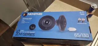

Gonna start with the rear speakers and work my way forward. 22 ZR2 bose is garbage.
Garbage indeed
i traded my 21 sierra denali for the ZR2 and im shocked at the difference. sierra bose was 10x better. bass , mids and highs were perfectly matched and didnt distort when i cranked my Disturbed, Godsmack or Kid Rick. i'll fix it and gonna start with rears. Memphis gets good reviews.
