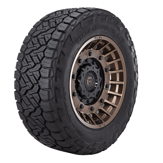

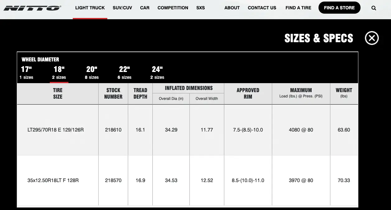

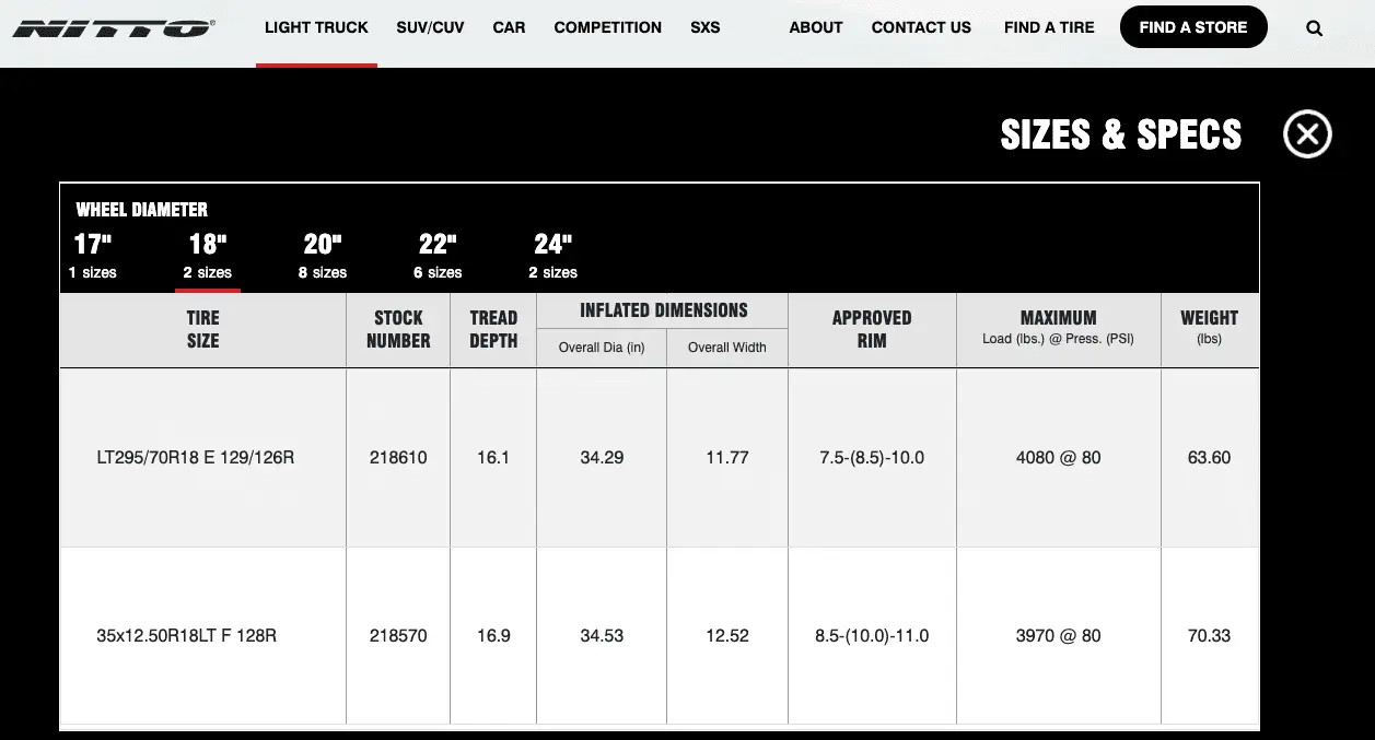

i Tried to put 35” ko’s on my factory wheels and they rubbed in the back of the wheel wells. I didn’t want to use a lift or level, so I put some Nitto Ridge Grapplers in a 295/70/18 on. There is no rub, truck is bone stock. I like the tires, a lot less noise than the Goodyears.

That looks really good! I've thought about going with a 285 75 18 on the stock wheels. I think they will fit without any rubbing.

Just to add to the conversation, BFG KO2 295/70/18’s release Oct 1.
69.4lbs 34.3” and minimum recommended pressure of 50.
It’s tempting, but increasing tire weight 15 lbs each and running 50PSI+ on range E seems like a heavy hit to the factory ride.
It’s ashame they don’t have more load range C tires for vehicles that are not in the GVWR spec to require E’s

They don’t rub. I like them. Haven’t had a problem with them.
