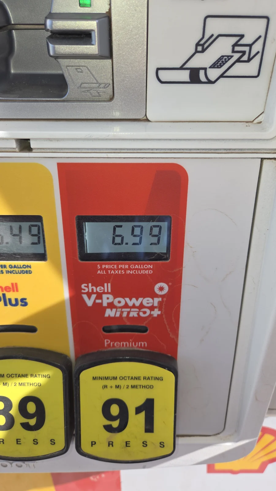

Never did the the 6.2L running 93 octane. Was wondering how dirty it gets.? I mostly run Shell V-Power, which is supposed to be really clean with good detergents. For $7 gallon, it should come with a free TB service......LOL.

My throttle body was spotless at 32K, when I changed my oil. I use Costco premium. Last week It reached $5.00 a gallon. I think it was down around $2.73 a few months back.

LOL....... that's the last station on the way out of town towards the lake. I think they have it dialed up $1.40 for the jet skis and boats. I just put in 5 gallons in my boat. It runs fine on 87, but I like to run a little through it now an again.
I think its still about $5.60 or so in town. Still people ripping around everywhere. I guess it's just a speed bump.
