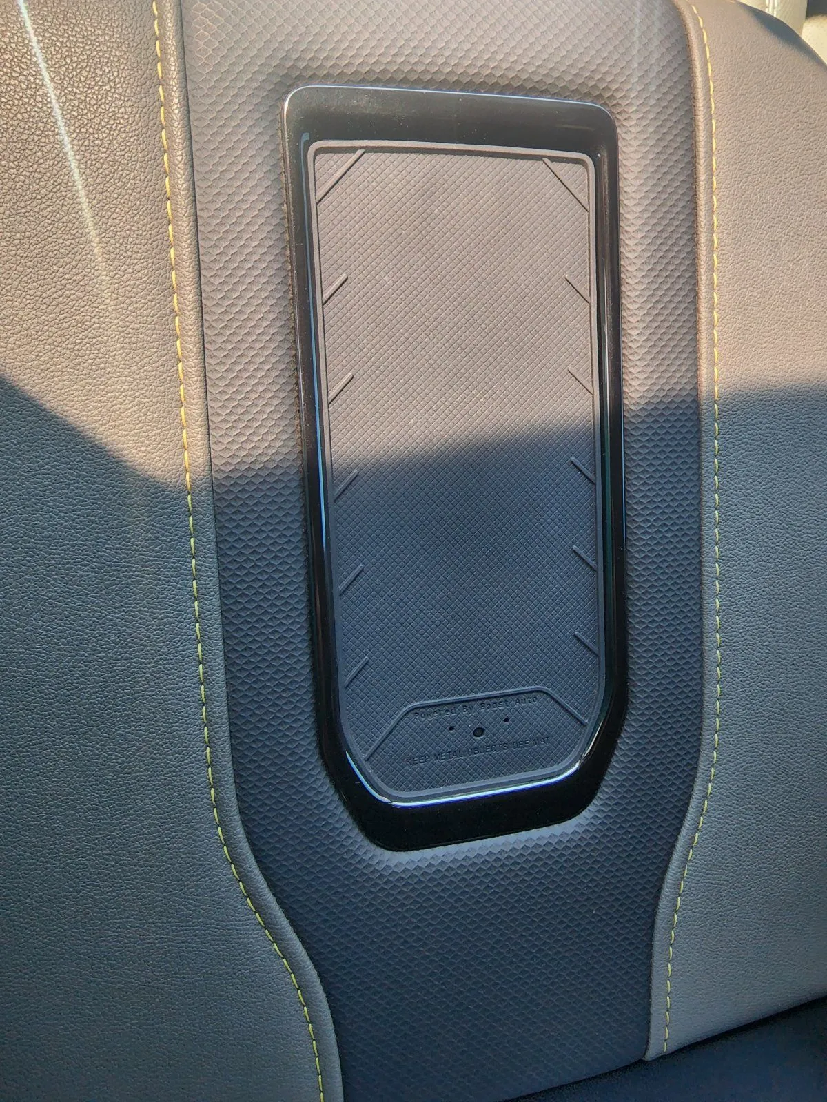

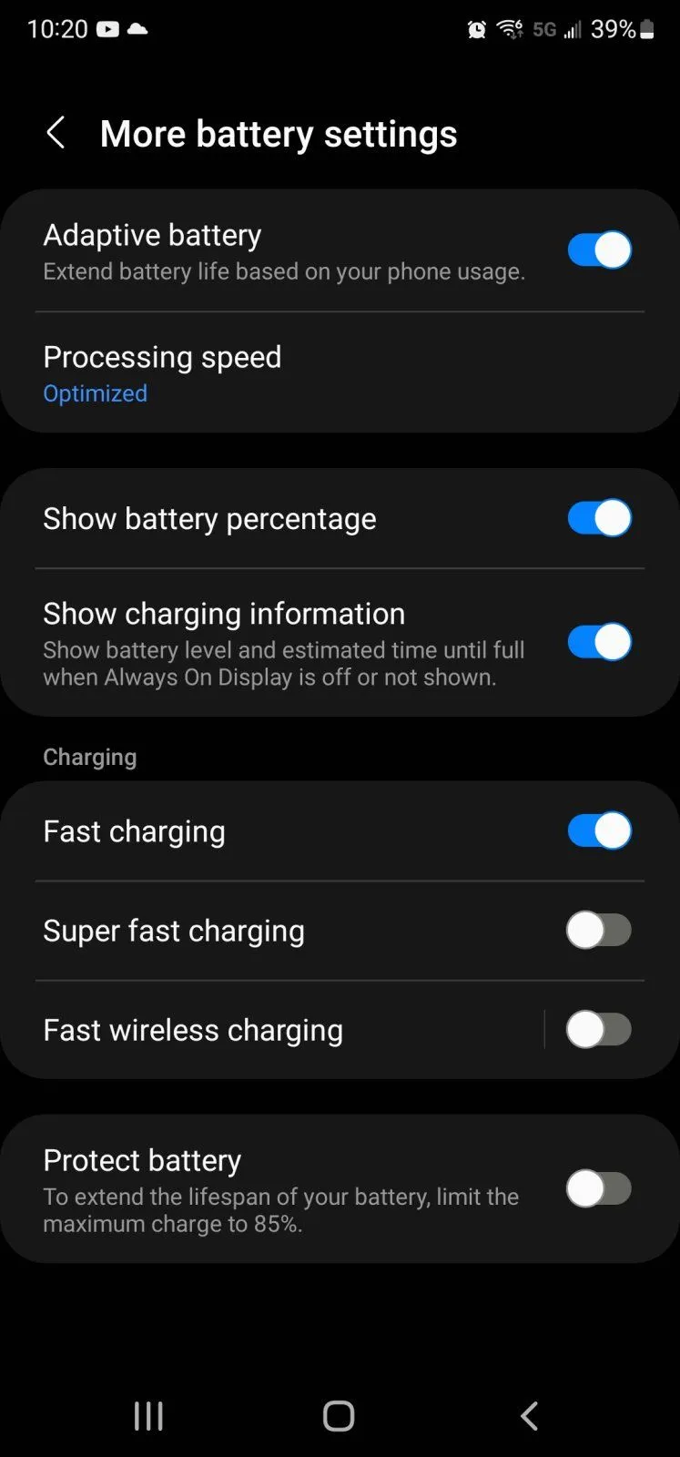

Two parts. For anyone who is having problems with the factory charger where charging keeps starting and stopping. If you have a android phone go in to settings, then battery and device care. Click on battery, scroll to the bottom and click more settings. Then turn off fast wireless charging. It fixes the issue. It worked on our 4 different phones. I was having the same problem in a refreshed high country, so it's not just a ZR2 issue.
It worked for me, the only downside is that it charges at lower speed.
I did enable Fast Wireless Charging again and I don't know but phone is charging very well everytime
So try to enable Fast Wireless Charging again and let know if your phone charges without any problems
  • Thread starter
  • #5
Hmm that's strange. I'll have to re-enable it and see what it does. None of our phones would charge reliably till I changed that setting. Charging speed hasn't really been an issue for me, but I'm not really charging a dead phone. I just wanted the charger to work cause the wireless android auto plus streaming music drains the battery pretty quick.

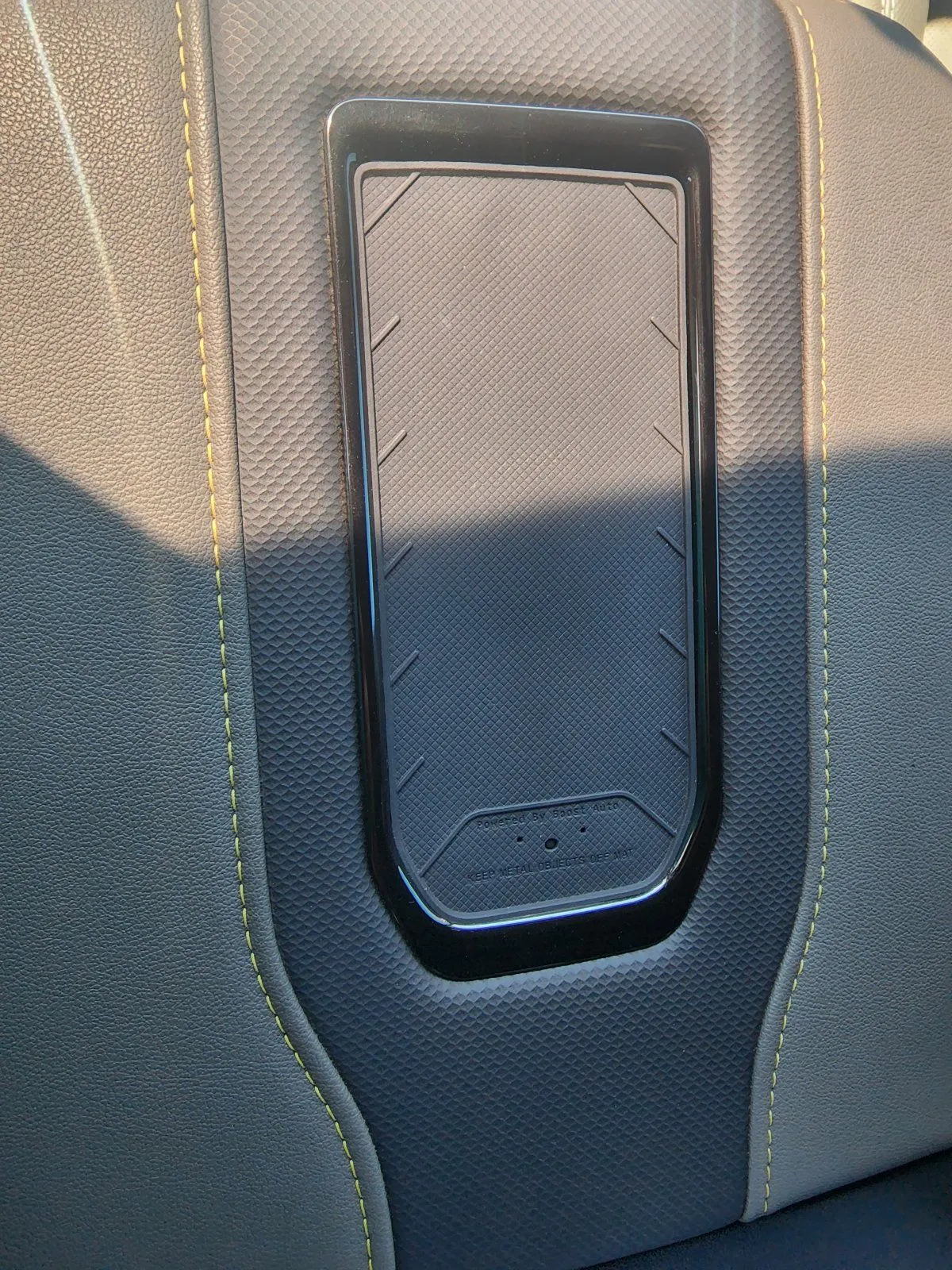

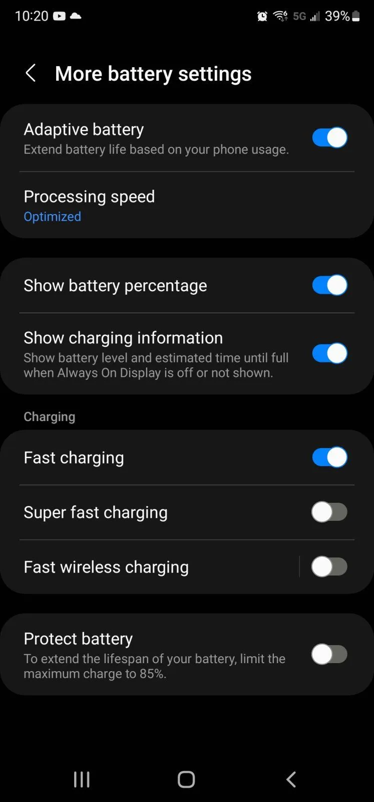

View attachment 908View attachment 909
hey it worked..thanks
