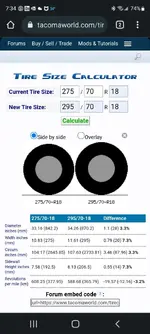

The 295 is actually taller and wider.
The tire size is coded, if you don't know. The 295 means the tread is 295mm wide. 70 means 70% of the tread width is the height of the side wall of the tire.
So even if 2 tires have the same middle number, the 295 will be taller than the 275...
