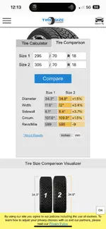

Just curious, but has anyone tried 305/70/18? I have the peak 1” lift and was curious if I could go bigger than the 295’s on stock wheels
