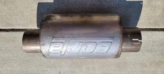

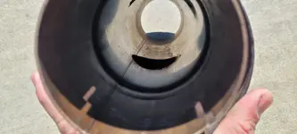

If you just bought the Attack muffler and not the cat back system designed for our trucks; you will have drone, no matter what you do. The mufflers designed for our trucks in the cat back systems are different. If you look down the center of the muffler there is a round cutout that kind of acts like a Helmholtz resonator to eliminate drone. I even removed the resonator behind the muffler and installed a straight pipe, and I still have ZERO drone.
The first pic is the rear resonator I removed and the 2nd is the hole I was talking about. Both the muffler and the resonator have them. I don't believe the crate Attack muffler will have it.
