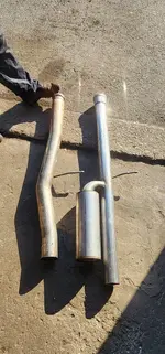

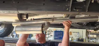

not even close. back to the drawing board. i am actually speechless its so far off.

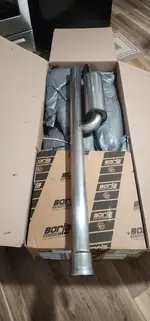

What in the hell!? Did they mock it up in a coloring book? I don’t even think you could trim to fit. The rest of the exhaust is 3.5” correct?

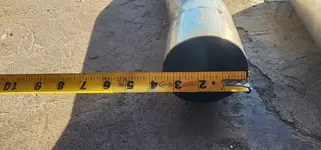

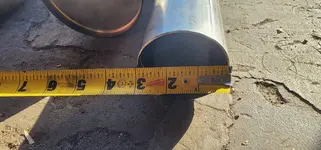

issue 1- sent 3 inch new pipe. exhisting system is 3.5 inches.
issue 2- new pipe is straight where old pipe has multiple bends. bad angle.
issue 3- new pipe res is mount too far aft. even if you trimmed it would hit muffler. also minor issue of hanger wrong position. i was told the new pipe was plug and play to maintain consistency with system. NO WELDING. im bummed to say disappointed.
Definitely not minor issues. Curious as to what vehicle if any they used to mock the pipe up on.

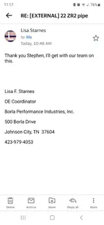

thanks bro. i spoke with Lisa Starnes at borla and sent her my install invoice and pics posted here. my preferred fix is to remove the borla muffler/res combo S type and replace with a measured single muffler set up. gotta be a muffler out their with good sound that would fit.

i was told that borla retail systems do not interchange with OEM systems branded with manufacturer part numbers. ie; borla gm # 19433388.
So, if you order the S-type from Borla you get a different exhaust system than the GM/Borla system? When I ordered it came in a Borla box with one little GM sticker on the outside. The exhaust system itself has no branding other than Borla stamped on it.
thats what i was told by 2 people. if you call for a retail system for our trucks, its not the same system. Lisa Starnes on the OEM side confirmed this. my fix was to replace S type with a touring muffler..was informed its not compatible. could be a marketing ploy. im also calling my dealer to see if they kept welded stick system. already too much drama for me.

The lack of support from Borla for “OE” equipment is concerning.
Also, looking at the install instructions (which are what I received inside my Borla box) I see no difference between S-type part number 140914 and the “GM” version I purchased.

i totally agree. i have spoken with both sides at borla and imo there is definite discontent between retail and OE. that said, im at their mercy. i was told wrong info from the get go about what was purchasing. you can only do so much due diligence. my gut tells me they have no clue and are making this up as they go along all while saying they are aware of issue. over $2300 in at this point...not good.
