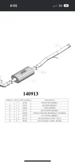

You will have to order a new front pipe from Borla And the touring muffler. It will bolt up to the rest of the catback. Otherwise you are cutting and welding.
I attached the part number list directly from the touring version of the ZR2 catback.
