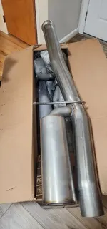

i hear you...i try not to get pissed off at things i have no control over. this imo is plain ole not giving a f**k!! zero quality control. i also didnt wanna do the pile on but i could have made better welds with my harbor freight 120v.

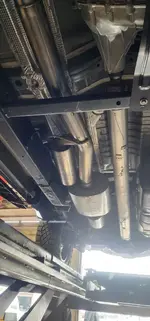

here we go 2nd attempt. this pipe looks correct with the bends. should now within an hour or two🤞🤞
yes, just eyeing it up, bends and length seem ok for plug and play. Borla was embarrassed and couldnt apologise enough for the snafu. they overnited the new pipe. gonna give them "A" for effort.
Happy they could make it right for you.

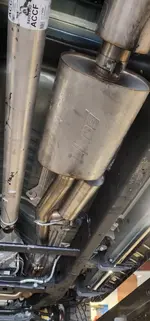

fyi...forgot to include installed new pipe.
