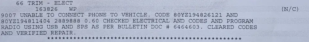

For those wondering what happened to this issue, my local dealership just tested the fix on my truck and the issue is now gone. You may wanna reach out to your local dealerships for the update. It is a USB port update and a radio update and now the issue is gone. Just done today.

Do you mind sharing your work order. It “should” have details that might help others when dealing with their Service Department.
I've posted this a few weeks ago. Not sure it's the same update, but seems like it probably is. There's a bulletin number listed. Also I don't use Apple, so not sure whynit says that.

It would be helpful if you post a pic of the work order.

Awesome can you put a picture of the update number or what they gave you at the dealership? Thanks.
Called the dealership, they said the GM SPS code is 2810335. Not sure if that really help but they said that's what info that had for this update.
Thanks for going the extra mile to get the update number. This definitely helps. If I am correct, we’ve now seen software and hardware (amplifier) fixes to this problem. Going to get mine in once I find a service advisor and dealership that I can trust. There has been enough feedback in this forum to call BS on any dealership who can’t or won’t fix this issue. If GM were a real company, they’d send letters or emails inviting their precious customers to come in for the fix. Not happenin‘ is my guess.
They are top busy winding down their failed EV program.......like everyone else.
That code dates back to at least 2020 for trucks having similar issues with the old infotainment system. May still be part of the fix, but doesn't appear to be a new procedure.
