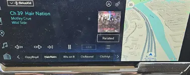

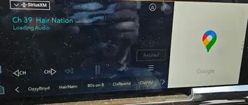

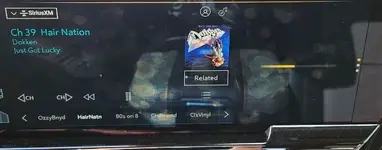

As luck would have it, I just got in truck and experienced another issue I've never seen. Map went dark and wouldn't load. A few minutes later it loaded, then went blank, then reloaded, then Sirius went off, then it proceeded to do this for 15 minutes straight every 30 seconds. Map wasn't even close to where I was at.This system sucks.
