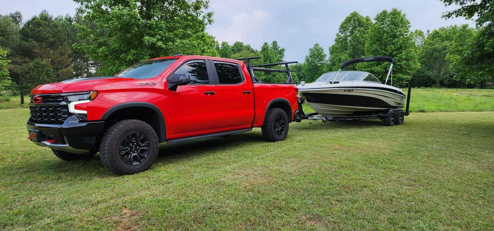

I've exceeded the GVWR on the truck by a significant margin on a 2,000 mile trip and aside from the inherent squat and the dreadful fuel mileage it handled it surprisingly well.

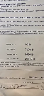

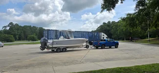

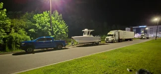

I know I'm pretty late to this message string. I recently got a Robalo r250 and towing it is a nightmare with the ZR2. I did put some sumo springs so I don't totally bottom out the suspension. But I've got to tell you the front end is very light both on the braking and the steering and at one point when I was going uphill the front tires lifted off the ground.
I'm really wondering if airbags and upgrade brakes are really the solution or should I be looking at the 2500?
The boat weighs 6,000 lb dry, it has 165 gallon tank and I'm assuming the trailer which is aluminum is about 1,800 to 2,000 lb.
If air bags are the answer I'd love to know some specific models that fit the ZR2 1500 because I haven't found any that claim to fit.
Your way past the rear axle limit right now. Its not at all safe. I have both and I think the 1500 is good for 6-7k lbs, but I still have bigger springs or air bags. If your towing over 8k regularly and want to do it safely and effortlessly, then a 2500HD is a good investment. There's some great mark downs right now on 2500HDs, get it done.

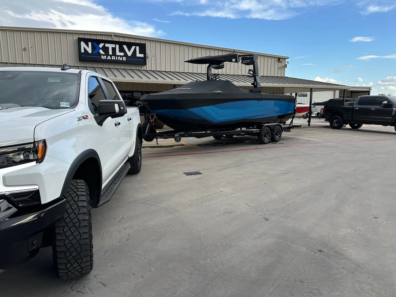

I'm currently towing a 24' Nautique GS24 behind my baby max with airbags. Your boat is definitely too big for the truck. I'm using the EZLift bags with a cradle to level and protect the shocks from being overworked. No issues towing other than the known DEF tank reading issues. Even without the bags the truck sits near level.
