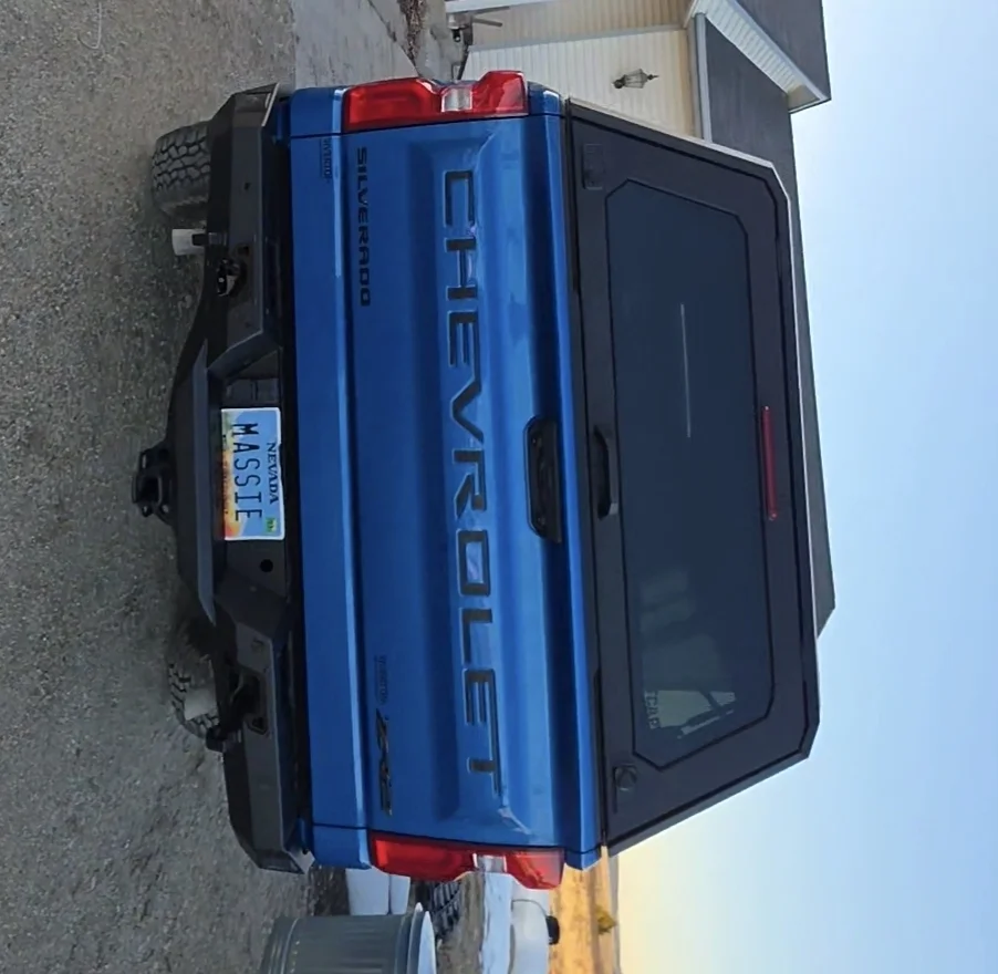

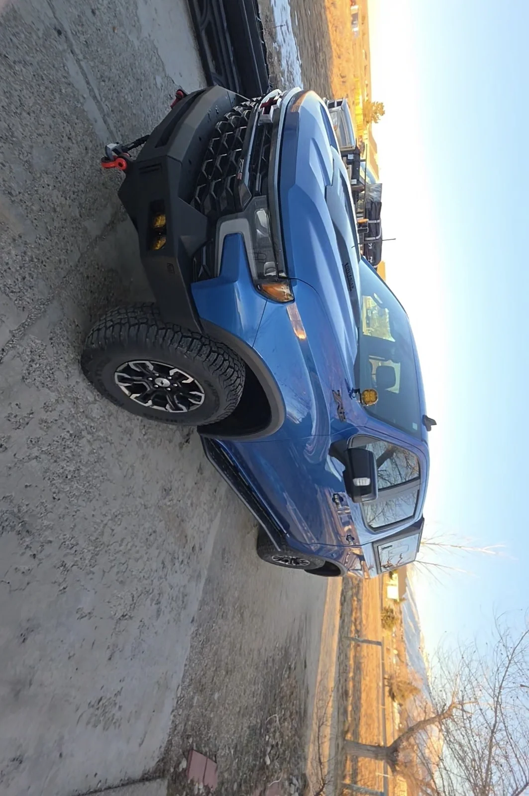

Chassis unlimited octane. I probs would of gone with the ADD bumper, however it wouldnt of allowed a winch with the diesel engine (intercooler).
It's a nice bumper none the less
I have the 6.2 and want to install a new one this year with a winch. It just sucks that there's not that many options yet. Does it work with the sensors? Is there any issues?
Yeah specialized aftermarket stuff is lacking forsure.
My truck is a 2024- they didnt have parking sensors. However both the chassis unlimited and the addictive dessert designs bumpers have the option for sensor cutouts. So they should work just fine.

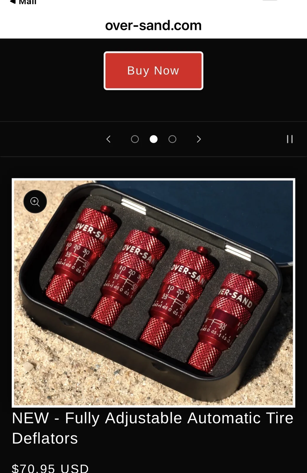

Picked up some new Oversand tire deflators, trying something new. I've used the valve stem removing style, four tire hose system and a single tire style with gauge, all have worked but these seem to be pretty good. I dialed them at 23 lbs (account for hot tires when hitting trail after highway drive), all four were +/- 1 lb so far when deflating.
I have a different brand, but these things are great!
Those look great if you can dial in the pressure and walk away! 70 is kinda steep but If it's a set it and forget it deal that's great!!!

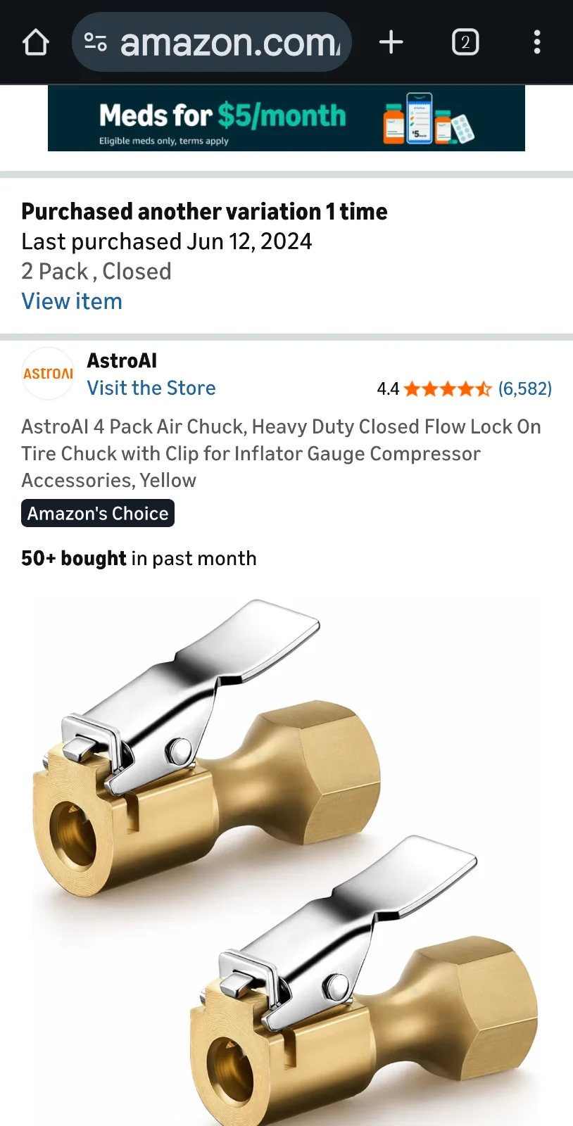

I chose these. They are extremely quick and I just use my DIC to get down to 18 to 20 for most trails. If it's really sandy or muddy then I take it down to about 15.
That’s cool! I tried the cheaper ones and they didn’t work, blew right past the preset I did, literally. The Staun are a bit more and pretty reliable, figured I’d try these that you can dial up what you want. I have options now for how I feel that day 😆
Yeah I had the rhino pin removal type but they were just way to slow for my taste. Please drop the link for the ones you purchased. I'll check them out 👍
Once you set the collars finger tight, may want to use some pliers to make them snug. Mine spun when I was screwing then the valve stem. Had to tighten a bit more but now they’re fine. Also, when I tested them, figured out they need normal tire pressure to kick them off. I was deflating and then back inflating to 5 over to save time, but they wouldn’t kick back on. Had to inflate about 10 over what I wanted it to stop at, if that makes sense.
