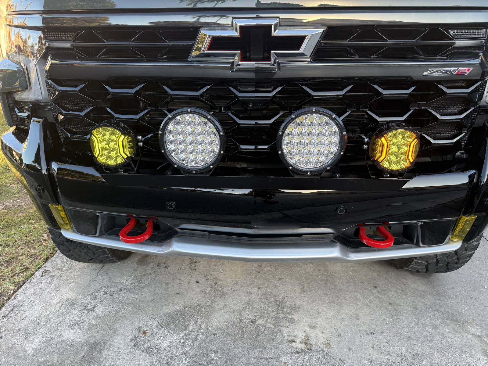

Gave her a bath today. Sadly though, 5 min later she was covered in pollen. Leave it to FL to think spring is the first week in February lol. Had a hell of a time getting water spots off the windshield though. Had to break out the vinegar to get it off then respray the repellant on it.
