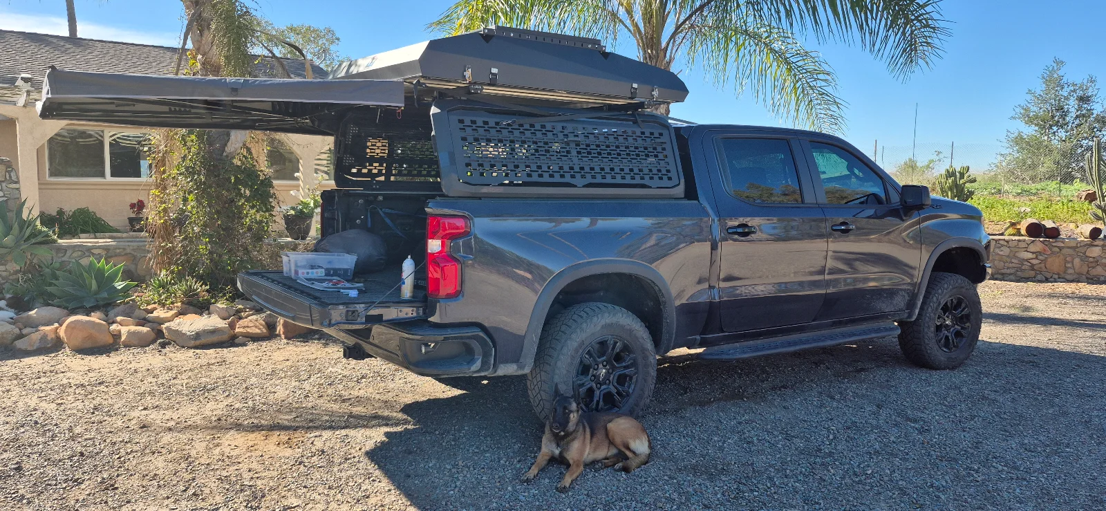

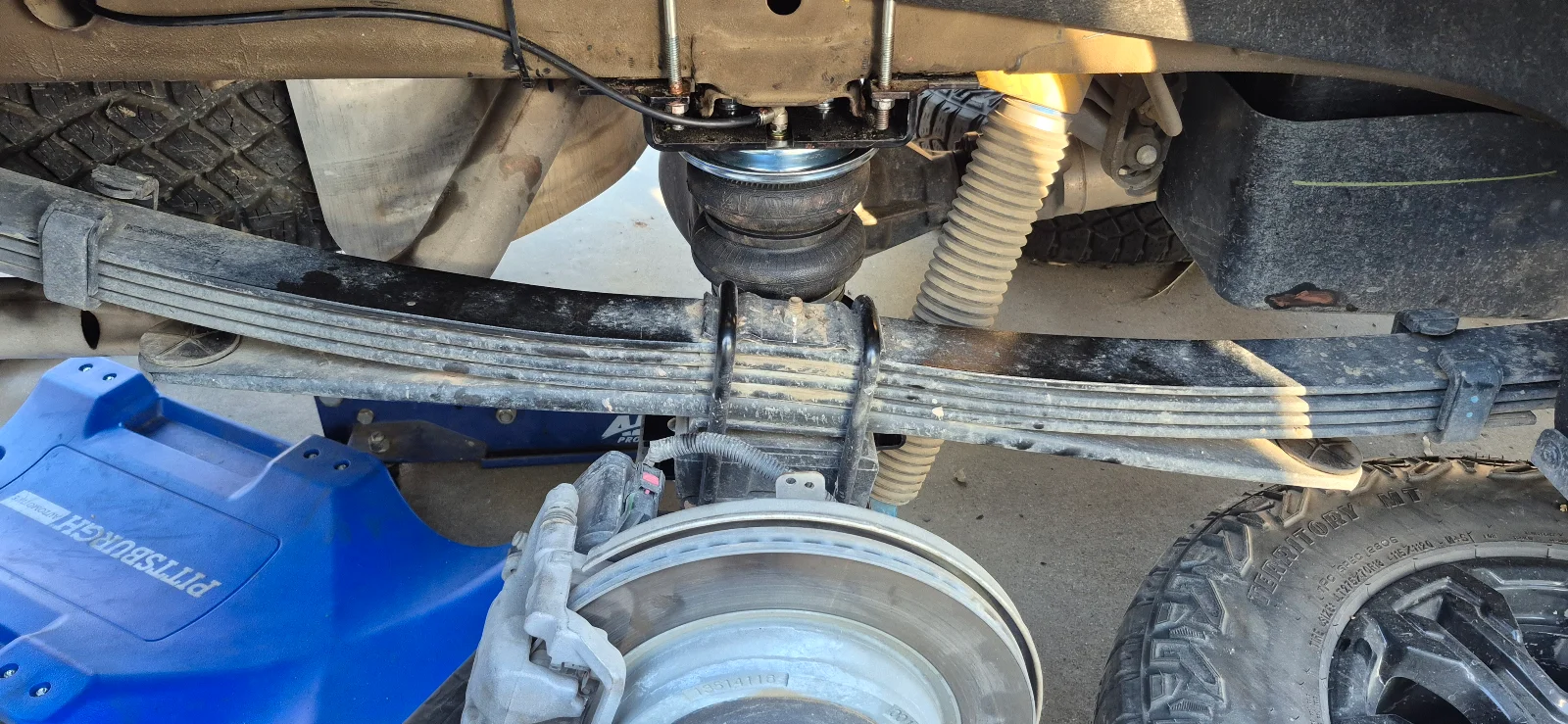

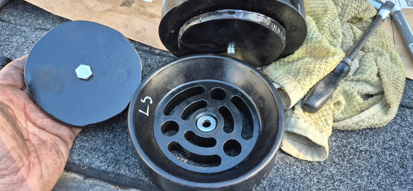

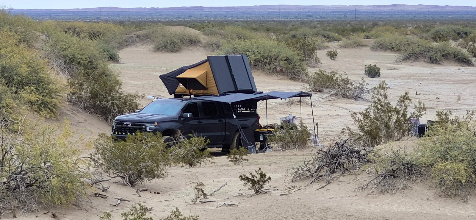

Bags for the weight from a roof top tent, awning and other camping equipment

Had bags on my 22 at4 3500. Made it ride like a brick. On my zr2 I went with the tembren bumps and road active system...way smoother

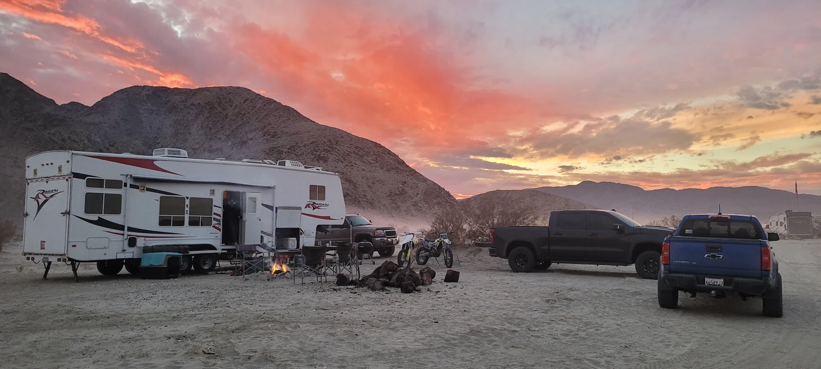

I've put air bags on a super duty and have them currently on my 3500.
I haven't had any issues.
I run 5 to 10 psi unloaded.
The 5th wheel weight is 12768 lbs empty.
150 gal water alone, loaded?

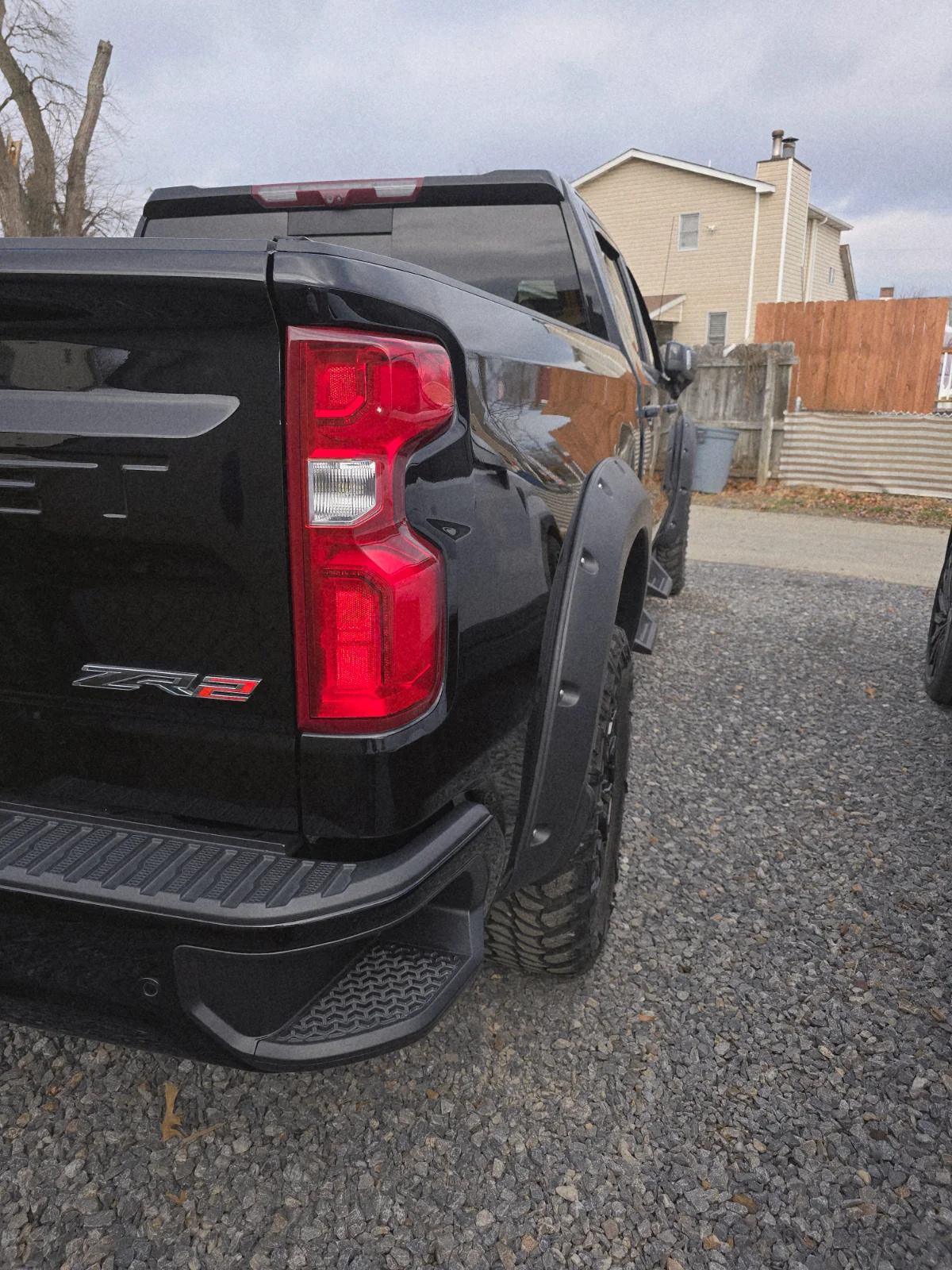

Finally put fender flares on my 1500 ZR2. They don't make fender flares specifically for the ZR2 so I had to get fender flares for a regular Silverado and custom cut and fit the front fender flares because of the different front fenders and bumper that are on the ZR2. What do you all think? Should I leave them flat black or paint them gloss black to match the truck?

Oh man, I love those. Which ones are those that you cut?

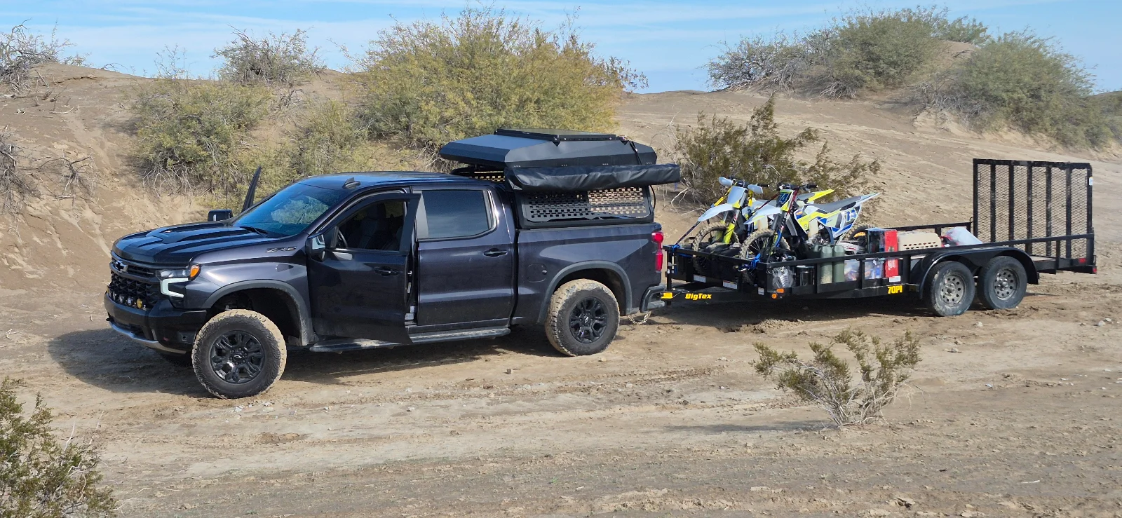

Might be I'm lucky.
Campers are notorious for making any vehicle vehicle handle crap.
I also like that I can put more air in to raise the trailer/hitch off road to avoid tongue jack damage from dragging
I'll post up if it rides like shit.
The 3500 tows great on bags with the cognito lift.
(I don't recommend cognito)

I can't find the receipt to see where I got them. There is a thread about fender flares here somewhere. I posted the link in that thread.

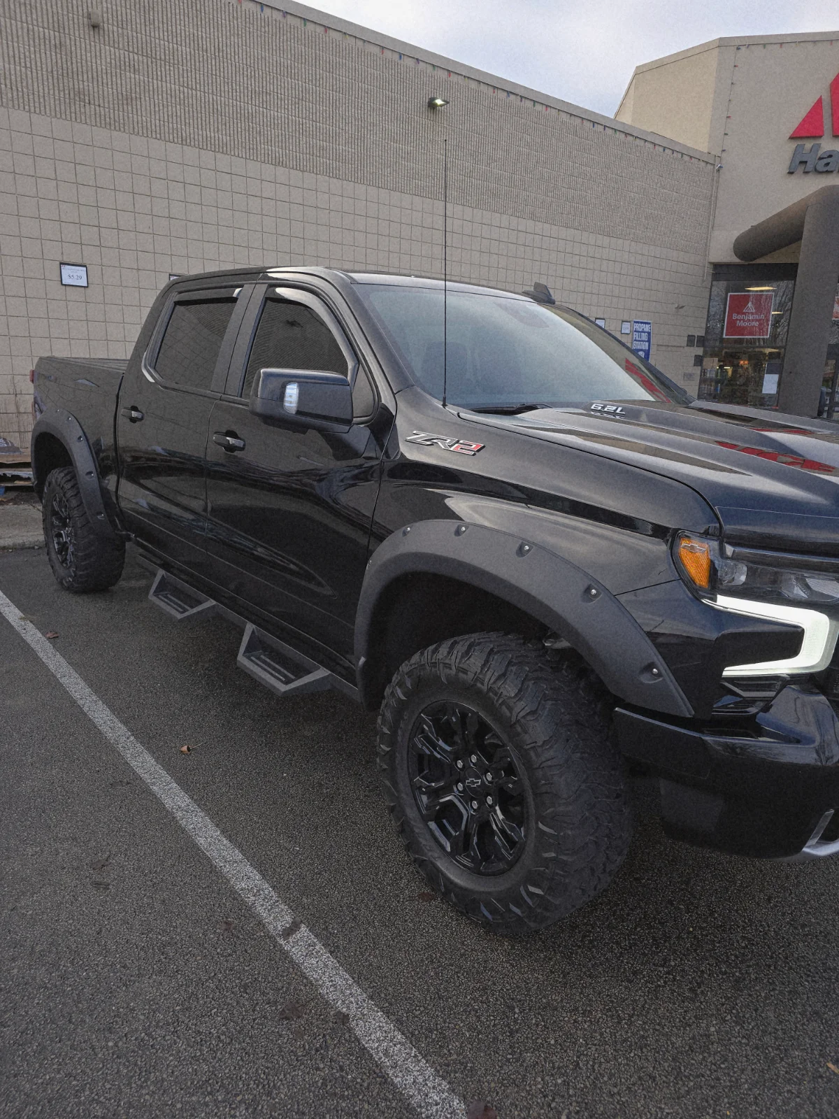

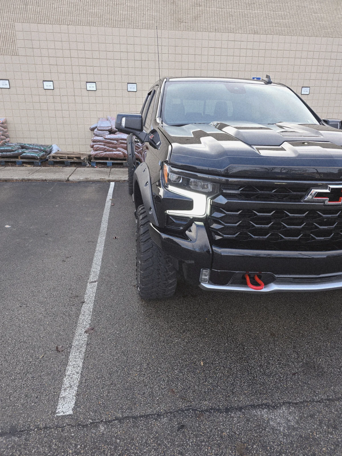

View attachment 25316View attachment 25317View attachment 25318
I like the flat and gloss contrast... Makes them pop! But like @AXE said, gloss is probably easier to keep clean... Nonetheless they look great 👍
Thank you! I'm still debating on taking them off to get them color matched, but installing them the first time was kind of a pain in the ass so not sure if I wanna go thru all of that again. Took me a little while to get them right. Worried that if I take them off I won't be able to get them back on exactly the same way and they won't look right.
As for now, I' m pretty happy with the flat black, gloss black contrast, so maybe I should just leave well enough alone. Don't fix what ain't broke, right?

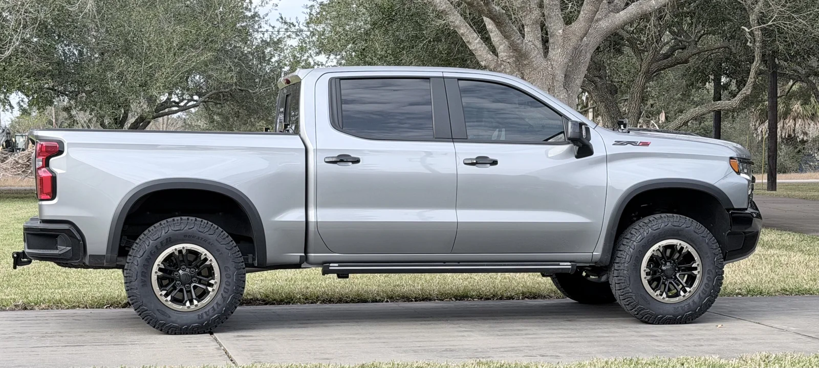

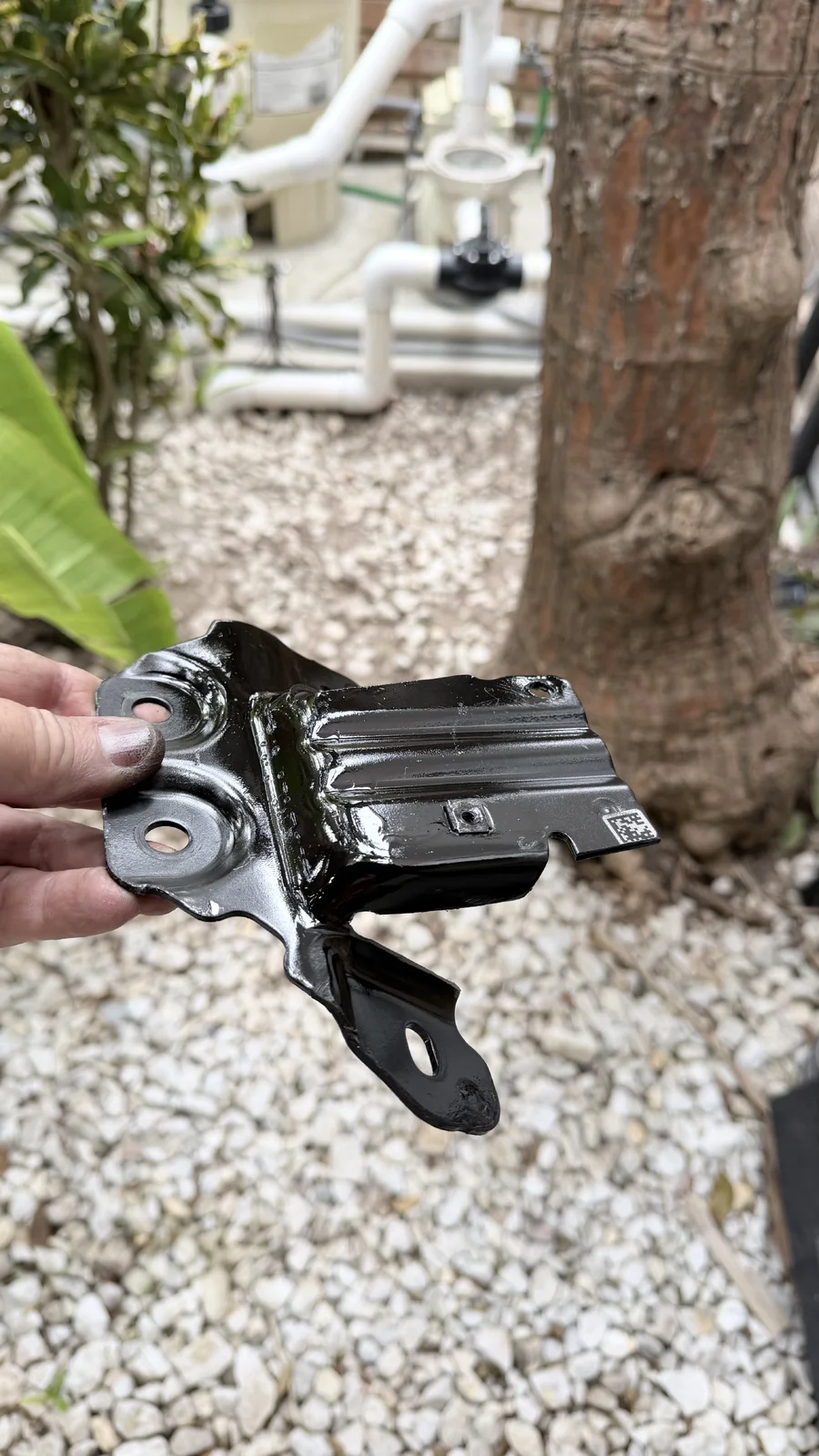

Out with the old 33” and on with 35” tires. Opted for 285/75-18 to get the true 35 inch tire. I had already installed the Peak 1/2” bumper spacers, so no rub there. I followed @AXE trimming suggestions on the rear portion of the front wheel well with a little more cutting of the bracket to pull the liner back a bit more.

Oh look, another Boost Auto Lumastep owner :D
