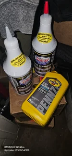

Just under $200 after all is said and done for this oil change... It would be about $40 cheaper if I didn't use the Lucas, But for me it's worth it!
