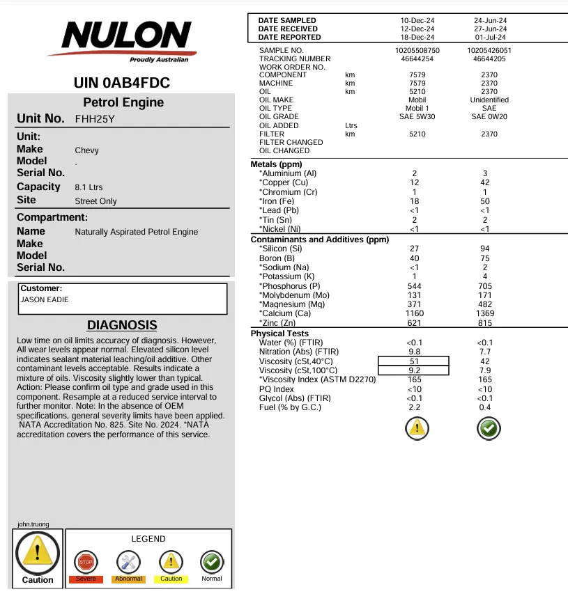

Hi Guys,
Thought I'd jump in on this thread, post mine and ask a question.
All levels have dropped off between tests (note the Australian distributor changes the oil to 5w30 on the first change for local conditions)
My question is have you guys experienced high fuel % in the oil? The analysis Guy said to not be too worried about it and attributed it to short runs and not getting hot enough to burn the fuel off in the oil, said it was the biggest issue they see. The problem is its nuking my viscosity.
Thoughts?
P.S. I never let it get anywhere near the OD gears now around town...as per AXE advice L3 and floor it ;)

I don't think there has been too many issues with fuel in the oil, but could see that happening the way it's described.
That's another reason a shorter interval might be better for these motors. You just never know what they might be doing.
Not sure why they spec 5w30,but maybe try 0W20 and see if fuel dilution persists. Perhaps the cylinder pressure is higher with thicker oil and the rings are letting some air past. Not sure that is a real scinetific analysis, but just something that popped into my head.

I think what stands out to me is this...
This is 2 reports, they don't really form a trend yet.
There will always be some oil left in the engine when it is changed, maybe the 0W-20 diluted the 5W-30 some and could account for this lowered viscosity reading.
Even the oil analysis company says they see fuel dilution frequently, could this point to an issue with their test and maybe the result is wrong or skewed somehow?
If the test is accurate, are you running a very short distance/time to work and back etc.?
It isn't a good thing to run the engine hard until it is up to full temperature and has had time to expand the pistons to finish sealing the combustion chamber as much as possible to stop blow by.
It takes time at full temperature to boil off fuel and moisture, like a pot of boiling water, it doesn't evaporate in moments, it takes a significant time boiling to burn it all away.
I would say to drive gently until the motor is up to full temp, this will reduce cold engine blow by, and wait for a few more reports to see how things are trending, I had a fuel dilution report on my Camaro once, but it was just once and disappeared the next report and the ones after, and coincidentally the dilution issue (.5%) was the second report just like yours.
IMHO/YMMV
