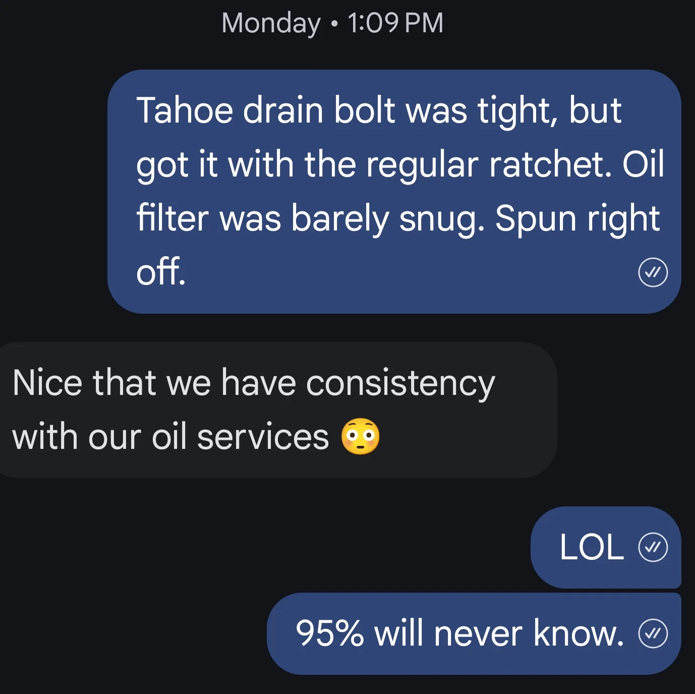

Sorry to hear this AXE. Hope you sent him a picture of the tools required and the carnage to the oil filter. That is absolutely ridiculous and no excuse. To bad you can’t take the line tech out back and have a conversation.
I've known him for 25 years and he's been good to me. They have done a lot of good work for me and they have one of the best diesel techs, who always likes working on my stuff cause it's well cared for.
I wasn't looking for a fight and I just wanted him to know about it. He apologized and said he would talk with the tech. By the time he called me back, I had gotten it off and there wasn't any damage, so we had a good laugh about it.
This was the last exchange in the folllow up for the Tahoe. I liked his response. He knows I'll give him a hard time next time I'm in there.....LOL.

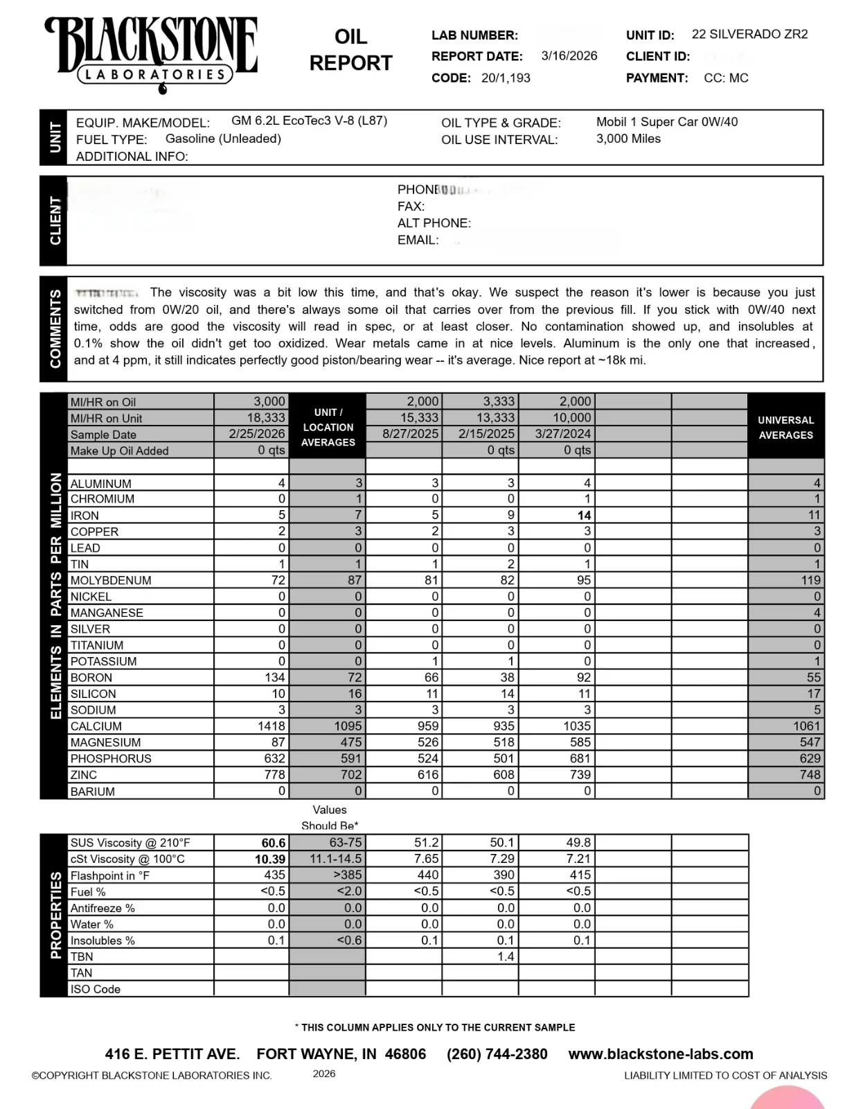

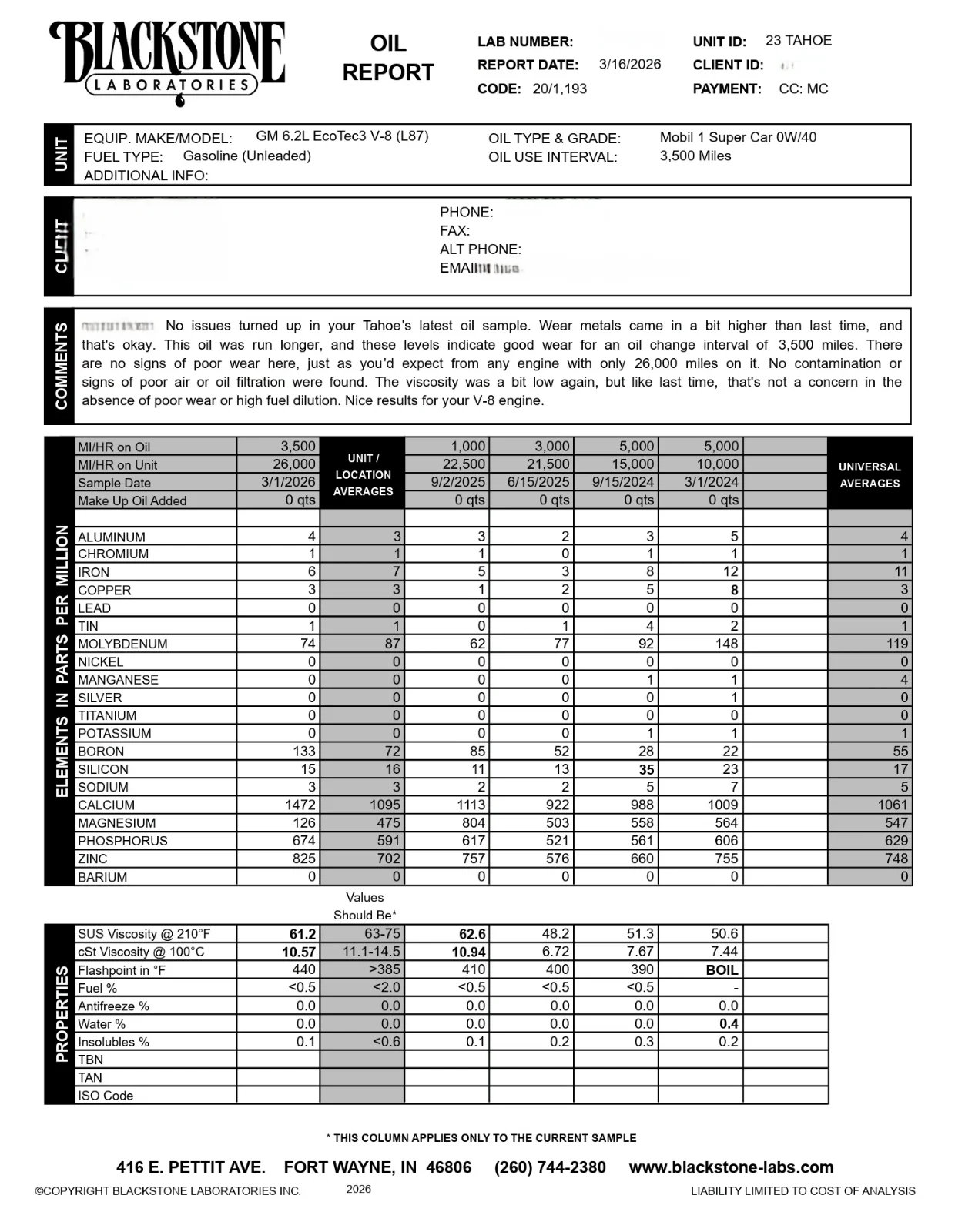

Got my latest test results on my 1500 and Tahoe oil samples back. Everything looks pretty good at this point. Not sure if I'll continue to do these or not. It'll be interesting if one of these turds blows!
I see the calcium is considerably higher on this oil and viscosity is lower than Mobil 1 0W40 FS. That's what some guys said on Bob's the Oil Guy website. Also see that magnesium is considerably lower.
I did a little more research and found that some formulations will run higher Boron and Calcium and low Magnesium to control ash build up. Looks like my 40 weight oil for my diesel oil analysis had similar balances, so must be something to do with the heavier oils too.

My first oil report from Blackstone came back today. 2023 1500 6.2 truck had 49000 with a fresh oil change from the dealership, sticker on windshield says Pennzoil 0w-40. I just did my first oil change on it at 53,500 miles using mobile 1 0w-40 supercar with mobile 1 filter. It had a gm filter on it. So these results look within average ranges for now we will see what happens with my next analysis. within that timeframe I've towed with it a handful of times, ripped through the paddles enough to put a smile on my face, and left a couple long ass strips of rubber in the golf course parking lot after league nights. I'm Always running it in L9. Still need to get the disabler.
Interesting to note the magnesium is low but calcium is higher on Supercar, viscosity is lower. All same as mine......I like Mobil 1 FS a little better for everyday use.

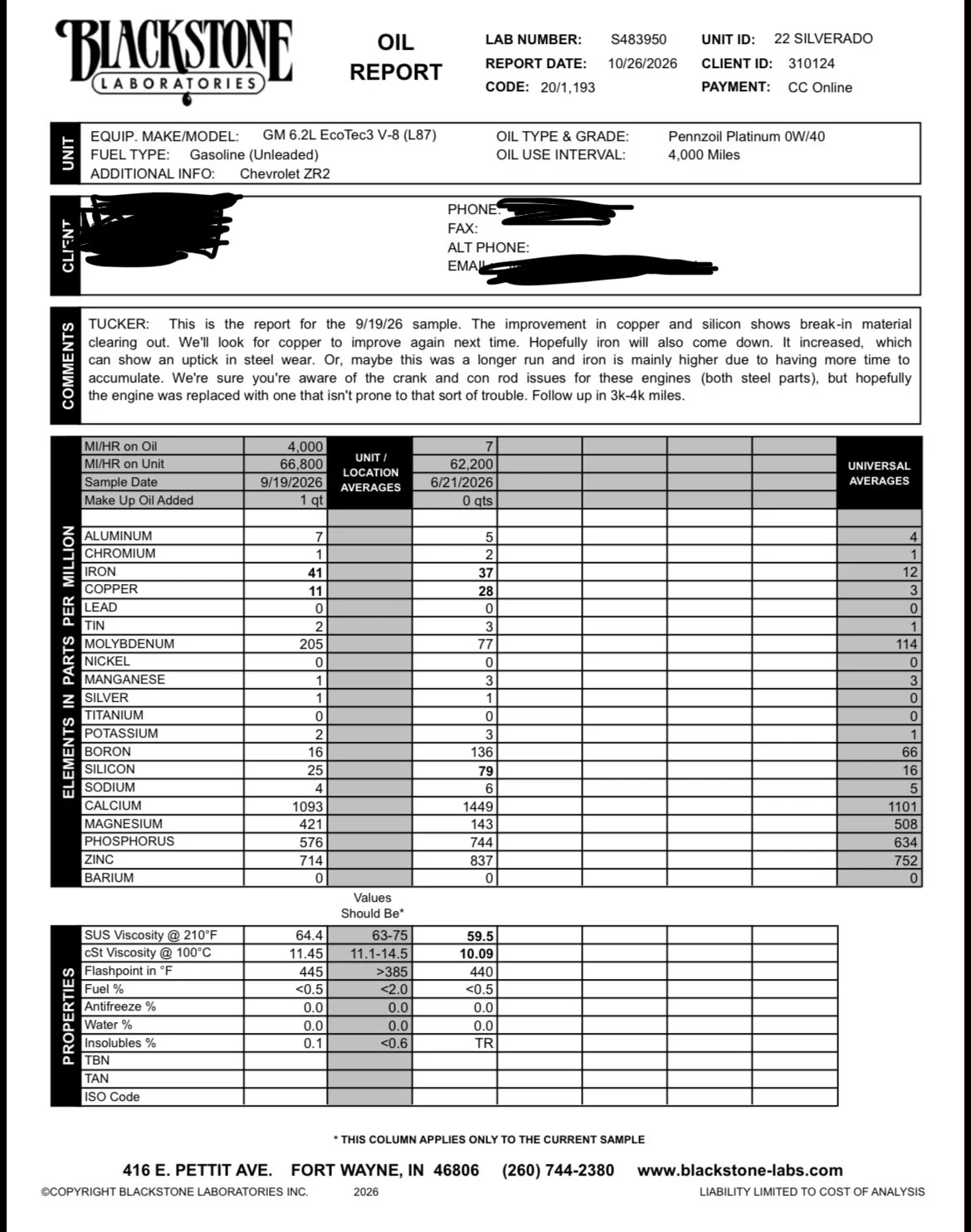

I rently did another 30k oil change on the Tahoe. This time it had 4000 miles on the sample, so I've been all over the map on intervals, but some of that related to the recall and viscosity changes.
I previously had a sample with ferrous metals too large to test. Then two clean analysis and filters. This test showed higher than normal iron, which is a wear metal for the bearings. The oil looked fairly clean to the eye and just a shade darker than the 3k changes.
Also when I cut open the filter, I did not like what I seen. There were many visible large and small particles and flakes (see photos, but it looked worse in person), The bigger flakes looked very bright like aluminum, but some of them pulled off with a magnet but didn't stick very strongly to the magnet) I would not expect to see that with a vehicle past the initial break in oil.
So not sure what to make of it, but I think this motor is heading towards failure. Maybe it's an anomaly and just a small piece of insignificant casting that let loose and got picked up in the fiter.

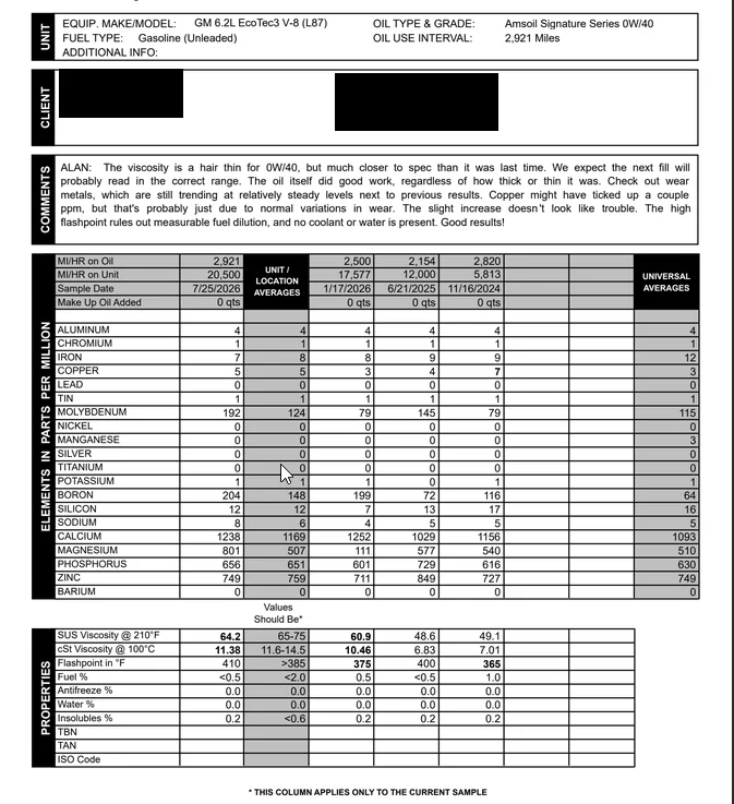

It's aiways interesting to see the variations in numbers. Since I've been inconsistent on my intervals, you can see the numbers change with more miles. Also notable additive package differences in the Mobil 1 FS vs Supercar.
