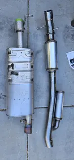

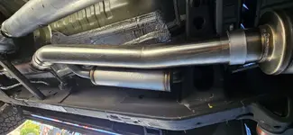

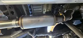

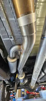

Here are a few pictures of parts and install. Really a nice quality system and fairly easy to install.

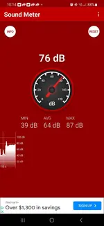

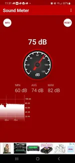

I ran a few miles on the highway between 55 and 75 mph. My sound meter was about the same at 75 to 77 dB cruising. A hair louder going up hill. You can definitely hear the exhaust more in the rear cabin. Not what I would call a drone, but just steady exhaust. I thing it's the DFM in auto mode causing it. When you run gears 7-9 and in tow/haul, it sounds about normal.

Start up/idle dBs on my meter vs stock.

No leaks that I could tell. The clamps are pretty wide and and have nice size bolts, so you can torque them down good and solid. I started them each and went back and forth between them a couple times to make sure they squared up good. There is about 2.75+ inches of overlap at each of the three well formed joints. There's about 1/8 to 1/4 inch play at each joint based upon the cuts in stock exhaust. Makes for a pretty tight fit. Will retorque again to make sure they don't come loose.
The rear joint is up high near the shock and hangers, so might be a little hard to weld. Possibly on a lift it would be easier.
